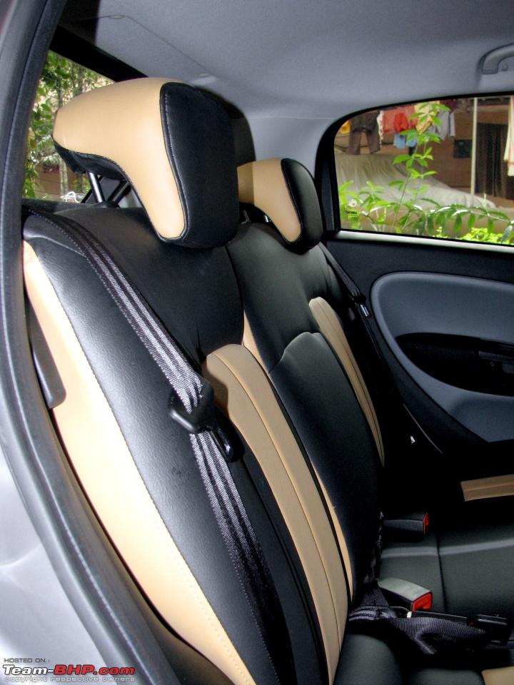

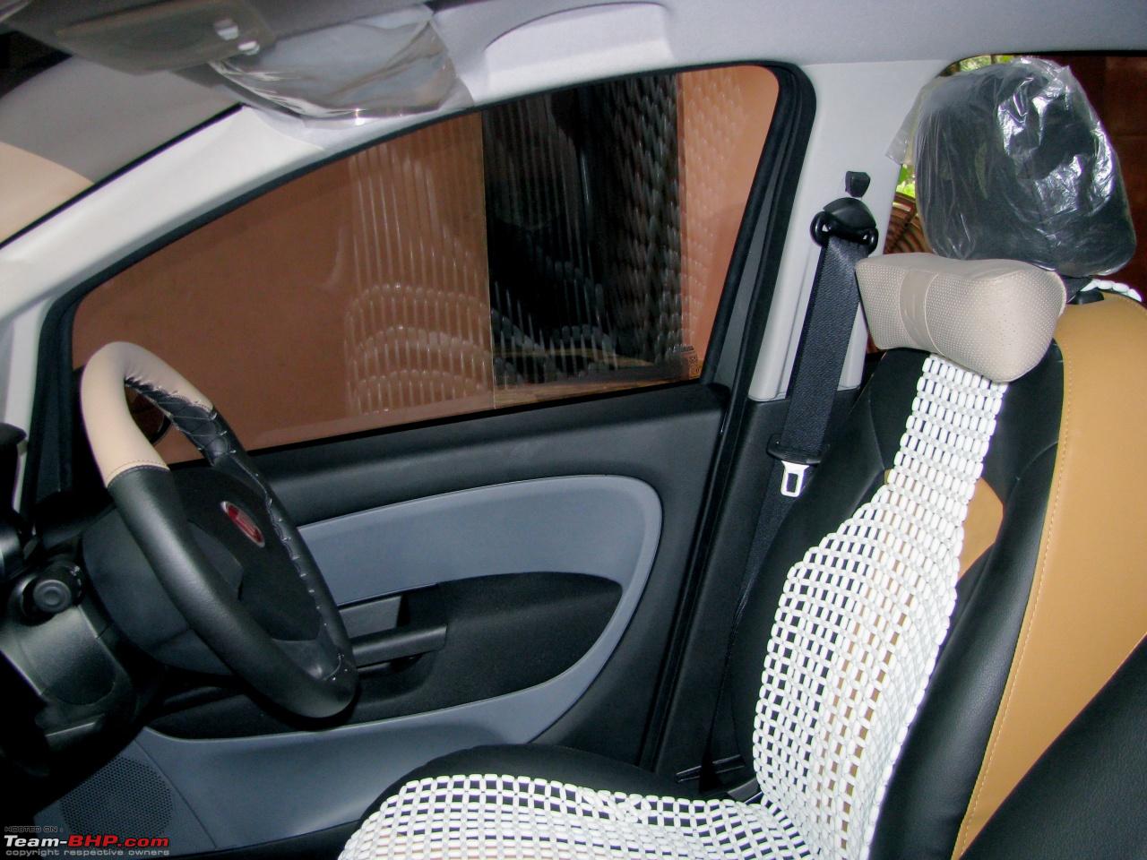

Uploading the interior snaps. front head rest covers are missing in some photos as i got it later only

waw. interiors looks very elegant mate.
if possible get an arm rest in same dual tone . They will surely give a premium feel!

Nice seat covers dude and a nice chunky looking inviting steering wheel too

Nicely done interiors soccerfan. The color combo looks fantastic.

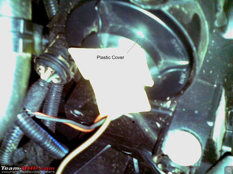

Update - Upgraded headlights to Rally 100/90
Having been blinded by the trucks and buses who never dim their lights, i decided to upgrade the lights in my punto. Thought of xtreme powers and night breakers. But they are too expensive, for its the bulbs only. Decided to upgrade to Philips Rally 100/90.
Component Wise split up
Bulbs - 155 (each).
Roots wiring kit - 515
Roots Relay - 157
Total - 982 rs (MRP) and the dealer agreed to do it for 900. Punto has a plastic cover behind the bulbs. This has to be either pierced or removed to place ceramic(plastic will melt away due to the extra heat) holder in the Roots wiring kit. I decided to pierce and route the wires as removing the cover can cause dust/water to enter the headlight assembly. The light has much better spread and throw now .Low beam is enough to drive in city. Refrain from using the high beam un-necessarily. 900 Rs well spent.Recommended upgrade .Punto Emotion - the driving diary - 15k/2nd service done-06022010002.jpgPunto Emotion - the driving diary - 15k/2nd service done-06022010.jpg

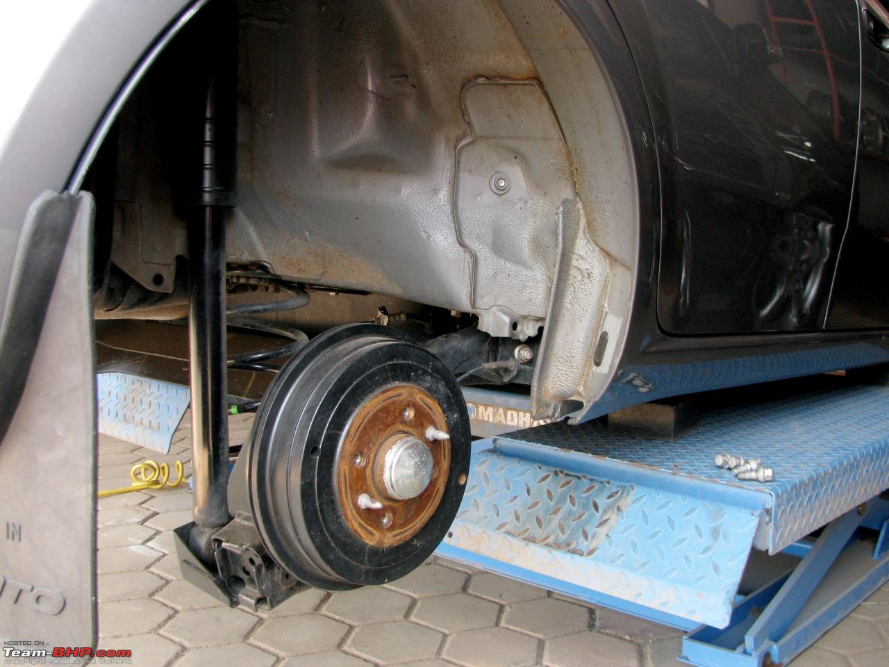

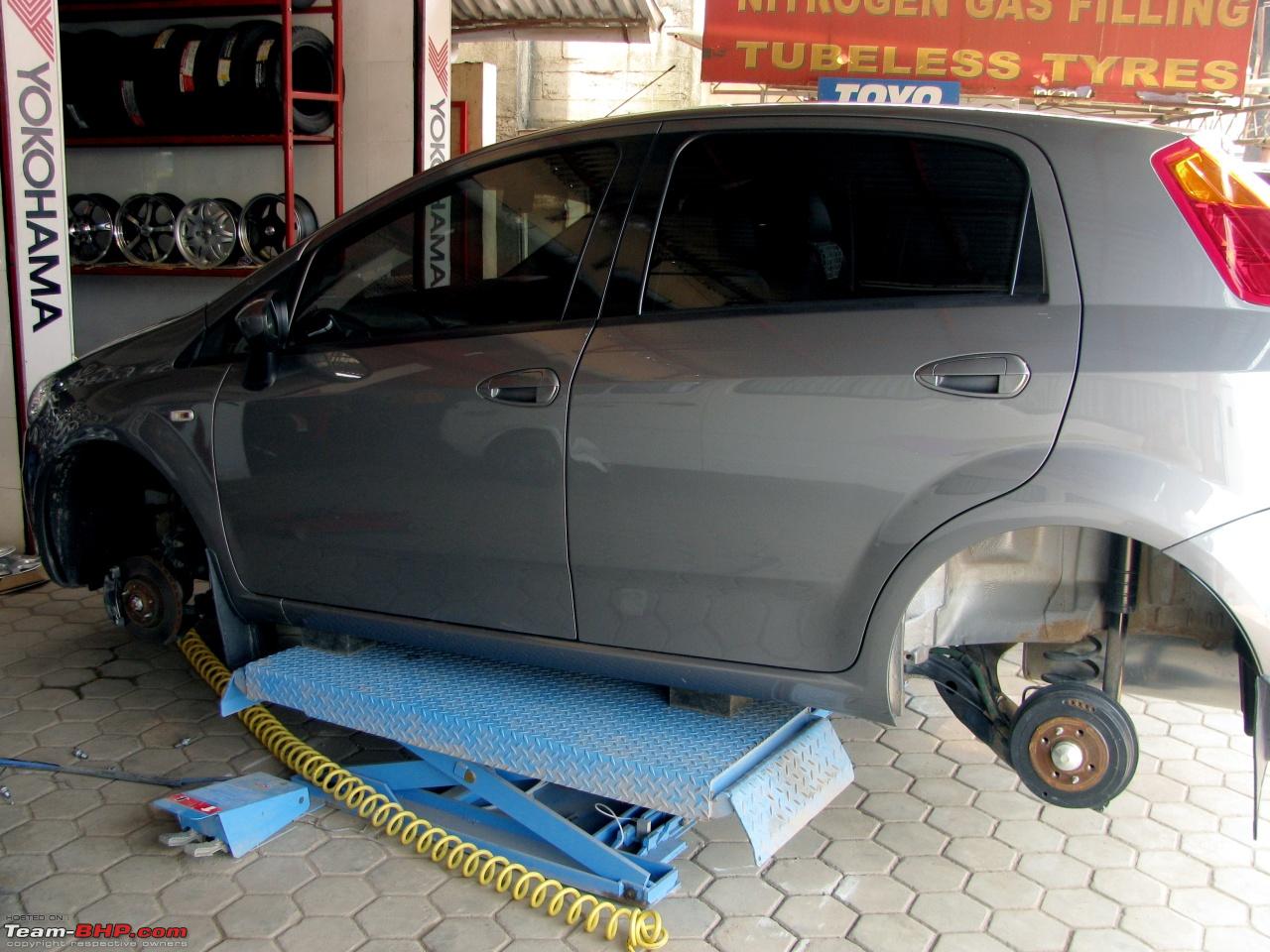

Went to speed tyres Kochi on friday. Wanted to upgrade the 175/70 R14 bridgestones to yoko A -drives 185/70 R14 . Main intention was to reduce the tyre noise. After bargaining the dealer gave the Yokos for 3100 each.
Job completed in 1 hour . Let the pictures do the talking

The tyres are a joy to drive on. Tyre noise is almost non-existent. you have to listen for it to hear and the grip also has improved . Very happy with the tires
