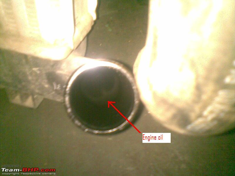

Drained the oil, measured, it came around 2.4 lit i.e., 700 ml less. He instructed the SA to remove the intercooler, oil separator and turbo tubing. Last two was fine, Mr. Allan said not to remove turbo, this may disturb the sealing thus, just inspected the tubings. But around 15-20 ml of oil was there inside the intercooler. According to Mr. Allan, this is normal!!
Swift Diesel.Vdi - Ownership report.Facing problems -Maruti refuses to honor warranty-intercooler.jpg
Swift Diesel.Vdi - Ownership report.Facing problems -Maruti refuses to honor warranty-intercooler2.jpg
Swift Diesel.Vdi - Ownership report.Facing problems -Maruti refuses to honor warranty-oil_intercooler.jpg
Mr. D'Souza entered all the comment in the job card and said me to monitor the car for another 2000 km and report after every 1000 km. Finally filled up 3.1 lit oil and changed oil filter. Changed the air filter too, because it was dirty and as per Maruti's revised troubleshooting of excess oil consumption, a dirty air filter may contribute in this. After observation period they will take a decision.

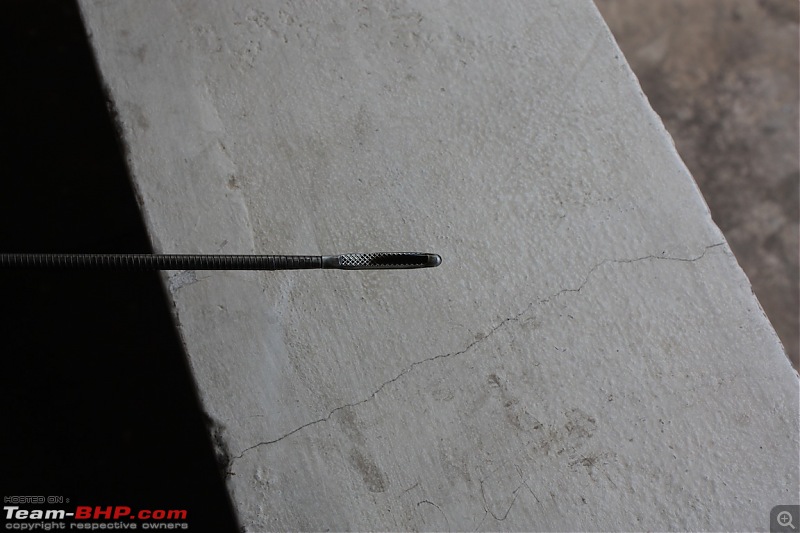

4000 plus kms after oil change
For reference last oil change was more than 4000kms and had done about 700 kms of highway driving, quite spirited at it. Oil was just below full mark after the oil change.
Swift Diesel.Vdi - Ownership report.Facing problems -Maruti refuses to honor warranty-img_2770.jpg
Jaggu is offline
Thanks Jaggu.
