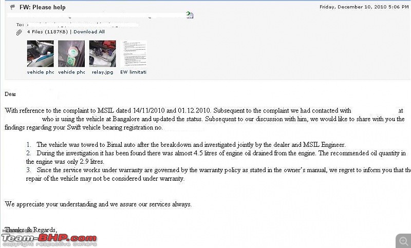

Thank you for the support. Got a letter from MSIL, they are clinging on to the extra oil found in the engine to void the warranty. My brother did top up the oil in a local workshop when he noticed that the car had overheated with low oil and coolant .It cost about Rs.750 including labor. The approximate quantity of oil filled is 2.5 L. They say that there was 4.5 L oil in the engine. So does it mean that we cannot even top up the oil in this car! But the really sad thing is the response to various e mails which I send to Maruti.I am posting the reply I got to the letter send to a senior official in service.
Swift Diesel.Vdi - Ownership report.Facing problems -Maruti refuses to honor warranty-letter-2.jpg
Dear Dr ,
With reference to the complaint to MSIL dated 14/11/2010 and 01.12.2010. Subsequent to the complaint we had contacted with Dr………..who is using the vehicle at Bangalore and updated the status. Subsequent to our discussion with him, we would like to share with you the findings regarding your Swift vehicle bearing registration no. KL---
1. The vehicle was towed to Bimal auto after the breakdown and investigated jointly by the dealer and MSIL Engineer.
2. During the investigation it has been found there was almost 4.5 litres of engine oil drained from the engine. The recommended oil quantity in the engine was only 2.9 litres.
3. Since the service works under warranty are governed by the warranty policy as stated in the owner's manual, we regret to inform you that the repair of the vehicle may not be considered under warranty.
We appreciate your understanding and we assure our services always

Originally Posted by Mevtec View Post
Dear friends,
Mistakes on our part
3, Did an oil top up at a local workshop in Hosur.
b, Using more than the recommended quantity of oil can affect the engine. The engine is said to be very sensitive to change in oil pressures. I don't know whether this is true. We have not over filled oil prior to the incident.
OMG It is highly dangerous to overfill oil more than the recommended amount of litres. Maybe the entire failure happened due to overfilling, there are so many threads in this forum explaining causes of overfilling engine oil, just check it out.

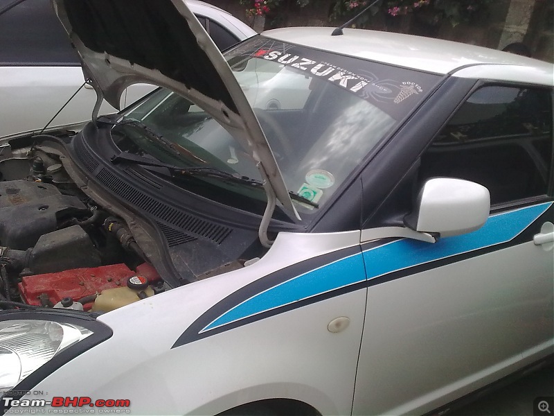

Few question came out while reading your thread:-
1. There has been large quantity of oil leak from your car, was it not noticed in the parking lot where you park your car(I mean oil stains in the ground)
2. If coolant is empty then the first symptom would be AC compressor getting cut-off, did you experience this?? I read your brother while driving experienced it however it was too late, it would have been experienced much before.
3. Did you happened to have a look at the temperature of your car from dashboard, i guess a constant look would have helped. Also check engine light would have glowed in case the temperature rises often
