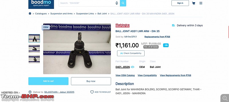

1. There are two Ball Joints (wheel joint in mechanic language). Since your jeep is 90k+ kms old, check out the condition some expert mechanic. In old generation Boleros these joins are prone to brake suddenly and vehicle get stuck at ’as it is where it is condition’.
Review: 1st-gen Mahindra Thar (2011 - 2019)-b-joint-lower.jpg
Review: 1st-gen Mahindra Thar (2011 - 2019)-b-joint-upper.png
