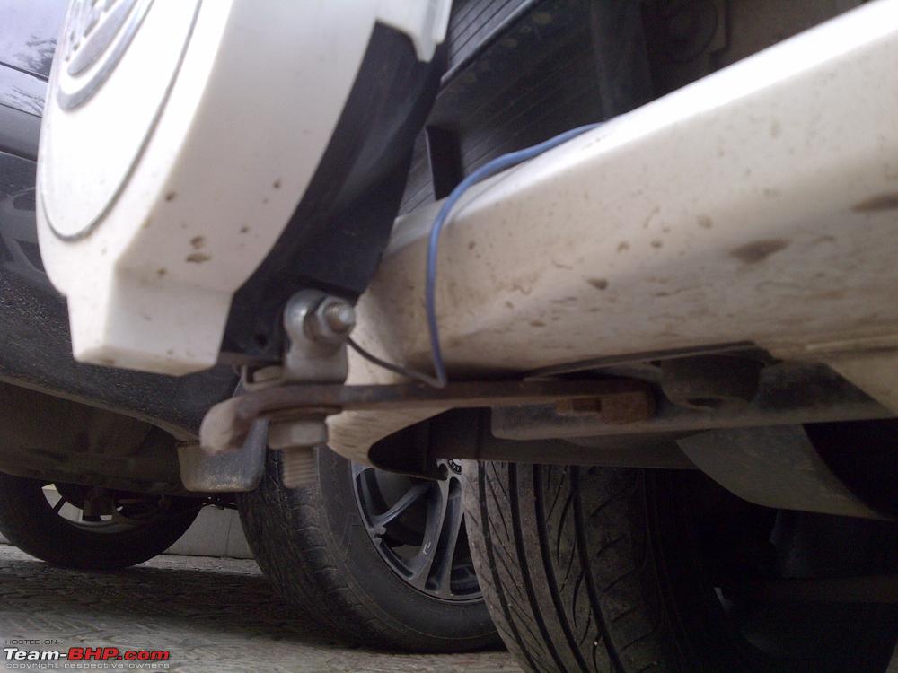

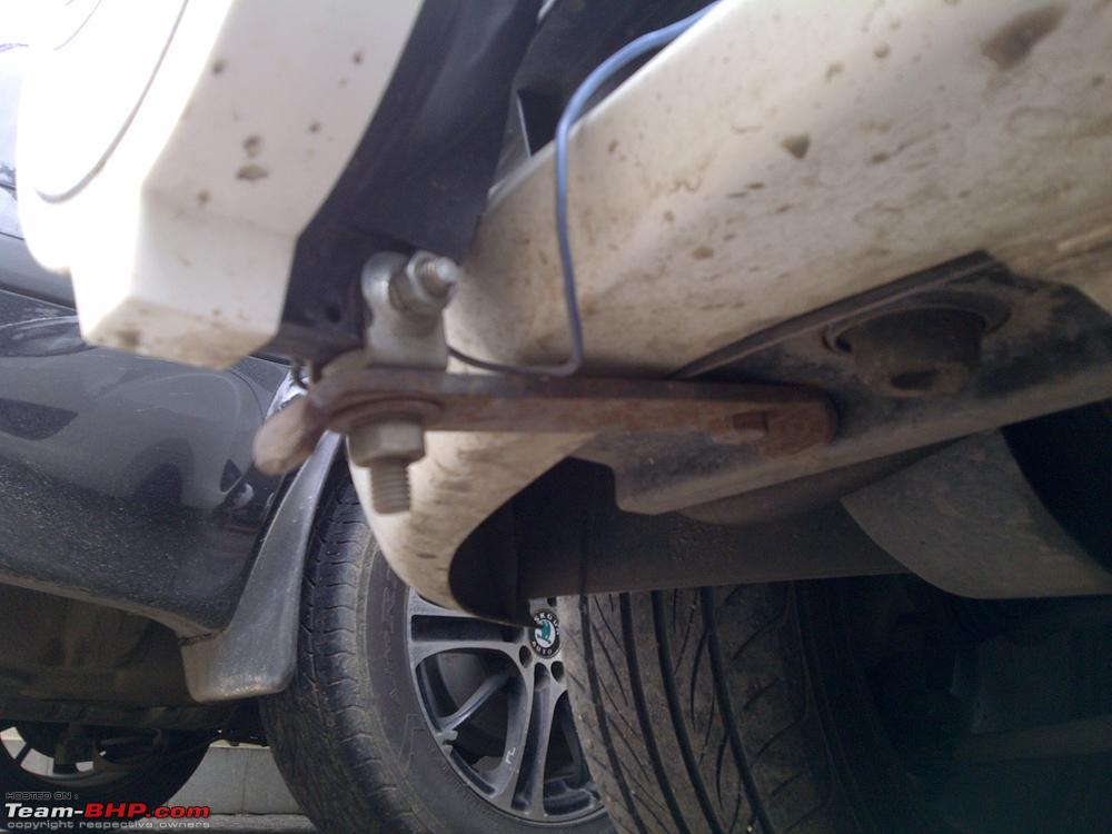

The only thing I had to get made locally from a welder was a piece of metal (bracket) for fitting the lights on the vehicle. I will try and get a close up image of this.

Whether You Sourced them from India or Imported them ? I searched in My town but I could not Find Hella Lamps here.
It would be nice in point of view of Figo owners if You do that. You have put those lamps at Fog Lamps level any specific reason ? Have you given any thought to putting them at HL level ? In my opinion they could have given even better results.

Q) Whether You Sourced them from India or Imported them ? I searched in My town but I could not Find Hella Lamps here.
A) Purchased locally at accessories shop. Hella products are available quite easily and I am sure there is a dealer in your town also. Hella India - they have a dealer locater also.
Q) It would be nice in point of view of Figo owners if You do that. You have put those lamps at Fog Lamps level any specific reason? Have you given any thought to putting them at HL level? In my opinion they could have given even better results.
A) I have appended photographs of the metal bracket used to fix the lights. Where the metal bracket is bolted to the vehicle, there was already a hole with nut inside.
Before I procured these lights itself I had looked at this point for mounting the lights. Hence no drilling/ screwing on the body.
Now primarily I use the lights only out of city limits. Primarily the low mounting was to ensure that no undue inconvenience was caused to oncoming vehicles.
Definitely, at high level the lights would have provided some improvement in the reach. But overall, I would give the lights a rating of about 4.5 out of 5. The reach and spread is more than adequate and primarily it covers the regions the headlight/ OE fog-lamps do not cover.
Thanks for valuable Info and Photographs clearly showing every nut and bolt. very simple and clean way of modification. I liked that very much, the only improvement I am thinking is How to made it easily removable and re-installable so that chances of stealing those lamps can be reduced by installing them as and when required.
