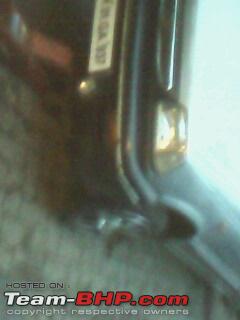

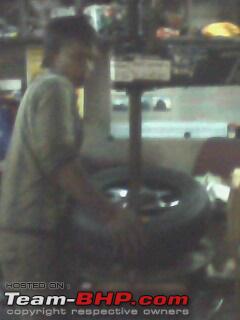

During Diwali holidays, I changed the tires of my M800 to Michelin XM1+ 155/70/R12 with new rims. Cost is 2500/- for each tire and 780/- for each rim.
And now, I'm facing the problem of rear wheel scraping the wheel arches. What is the correct air pressure for this size on M800? I've filled the air at 30 psi. What can be done to solve this?

Something wrong with the suspension ? has it sagged ? Because Ram Sir still has 145/80/R12 and even I had that in my 800 and our rear or front never used to scrape, even with full loads. 155/70/R12 should not scrape at all.
30 Psi is perfect. Check out if the rear plastic above the wheel has become loose and touching the wheel ? Or maybe the suspension has gone bad and decreased the ride height !

Humyum, I don't think anything is wrong with the suspension. May be it has sagged.
Like you said, I'll check the plastic above the wheel and also the bumper.
In case if the suspension has sagged, what can be done?

What kind of Suspension does your 800 have ? From the Pic I am 99% certain its the Zen type. Well in that case i am 99% sure its the plastic which is fouling with the tyres. Push it in with a hammer and you should be on your way.
This problem should have not happened in the first place, dunno why it happened in your case as many of us are/were running with 145/80/R12 and we never had any problems.
