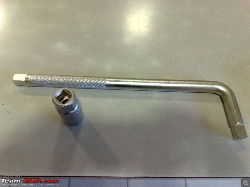

Long neck adapter and rod
Finally, picked up the adapter and rod which is able to reach the OEM nuts inside the alloy wheel holes. Costed Rs. 333/- including taxes.
To me this seems a much better solution, than those low quality allen key nuts I made the mistake of putting at the advise of wheel/tyre dealer.
Excuse the poor quality from the cellphone.
