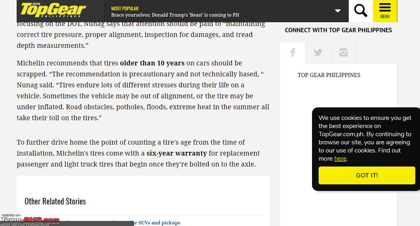

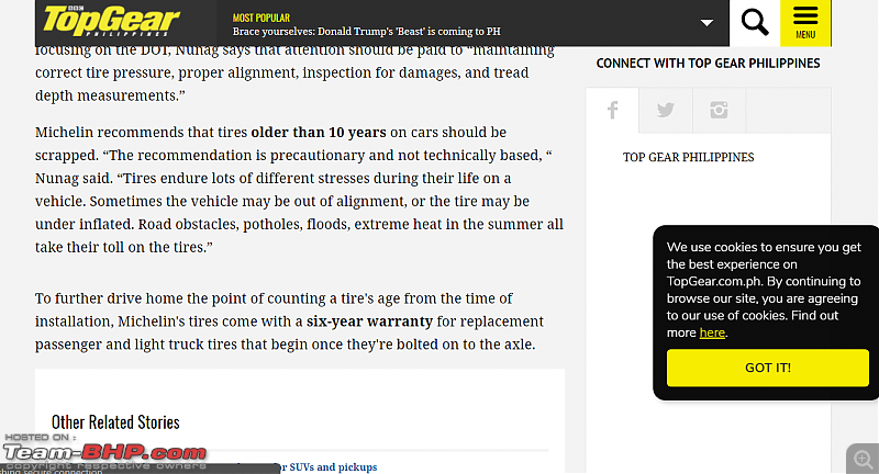

I did some digging for this image and got a clear one.
The fine prints has these 3 points, not necessarily in verbatim that "Studies show no difference in performance between new tires vs 3 year old tires - as long as they are stored in recommended storage conditions and lastly, they recommend that tires older than 10 years be removed from service."
Just reading between the lines of the Michelin ad got me thinking that they have used the word 'performance'. Is longevity a part of performance or not, that remains open to interpretation. Plus the biggest caveat is the statement - "as long as tires are stored in recommended storage conditions". Now, who certifies that and how do I ensure this as a customer when I go shopping tires?
Plus, this link (where I got this image from)(http://www.topgear.com.ph/news/indus...a1503-20170128) says that "Michelin's tires come with a six-year warranty for replacement passenger and light truck tires that begin once they're bolted on to the axle." which is absolutely misleading and false.
This is contradictory to what Michelin itself states on its India website:
a. Tyres sold within 3 years of the manufacturing date: Where the tyres are sold within 3 years of the manufacturing date, the warranty shall be for the life of the original usable tread pattern or 3 years from the date of purchase, whichever comes first.
b. Tyres sold 3 years after the manufacturing date: Where the tyres are sold 3 years after the manufacturing date, the warranty shall be for the life of the original usable tread pattern or 6 years from the date of manufacture, whichever comes first. At the end of the relevant periods stated in paragraphs a. and b. above (each referred to as the ‘Warranty Period’), all warranties, express or implied are terminated.
Regards.
