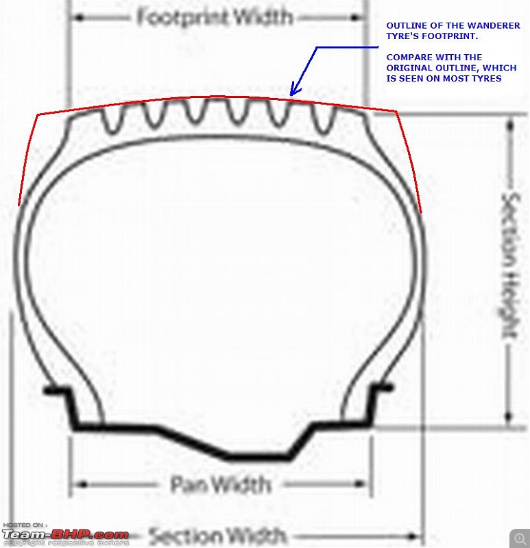

MRF's Wanderer range : said to be good, and not the run of the mill MRF's we know of. Available in both tube-type & tube-less type, and without a price difference in the versions.
Starting this thread to hear about experiences of users of these tyres.
And one question here : has anybody noticed the squarish section of these tyres ? Unlike any other tyre I have seen - including truck / HGV tyres, footprint is the widest I have come across, when seen in comparison to the overall tyre width. Considering this, what the pro's & cons of such a wide footprint ?
One way : you are getting a wider tyre (about 1 size wider that another brand would offer) for the price of a lower size. So should a person who is buying Wanderers buy one size lower than what he wants ?
If you are wondreing why I asked about the con's of such a tyre construction - well, every make of typre has the tyre tapering from it's widest part to the actual footprint width. With wanderers. this taper is much lesser. Also, it looks like the footprint width is wider than the mounting width (as seen on the rim side).
To confirm this observation of the width, I compared this Wanderer with Michelin's & Conti's of the same size (235's). The actual footprint width of the other two was less than the wanderers by almost 20mm !
To give you an idea, here's the comparison :

I will follow this thread closely. Illustration given above by @condor is interesting.
