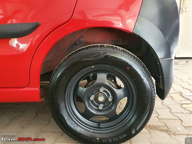

Been wanting to update here for some time. Upgraded my A-Star's tyre and rim. Moved from 13inch to 14inch rims. Being an old beater car I wasn't keen on alloys yet the standard 14inch rims from celerio were boring. And that is when I spotted the Renault Tribers 14inch 'alloyish' looking 5 spoke steel rims. Was actively looking for it and then found someone selling brand new unused rims on OLX.
Then came the hunt for tyres. I went for the same width as triber 165 which was a small bump up from 155 oe tyres. Anything beyond I thought was an overkill for a 67bhp car. The final size - 165/70 R14. Browsing through the tyremarket.com, I got a great deal on the Continental CC5 tyres. Have written about it here (Tyremarket.com Reviews? Buying tyres online) .
Armed with the tyre and rims I headed to Madhus for the fitting.
Maruti Suzuki A-Star : Tyre & wheel upgrade thread-20201213_111352.jpg
Maruti Suzuki A-Star : Tyre & wheel upgrade thread-20201213_111609.jpg
Maruti Suzuki A-Star : Tyre & wheel upgrade thread-20201213_125441.jpg
As usual a great experience at Madhus. The tyres were obviously super silent, compared to 5 year old MRF ZVTS. However I quickly ran into a problem - My rear tyres occasionally scraped. Somewhere I had screwed up. I knew that the overall diameter of the tyre wasn't that different from the previous set up. A quick check on the Wheel specs showed a few things.
Astar Rim : 100 PCD, 4.5J, 13", ET45
Triber Rim : 100 PCD, 4J, 14", ET 25
A quick read up on the concept of offsets taught me that the new wheel set up has ensured that the wheel doesn't go in as deep as previous set up, instead juts out a wee little bit. enough to touch the fender when loaded or when hitting a bump at a higher speed. This got me trying to figure out the solution. Finally thought I will go in for the Autocue Ground Clearance kit and buy myself some extra MM.

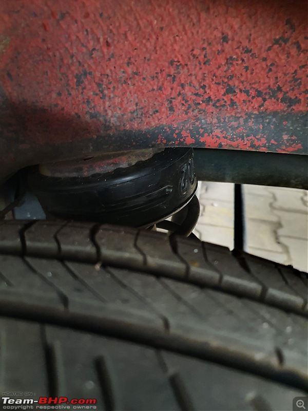

You scraped the wheels at that under-pass ? Looks like you were coming from Sarakki side towards Delmia - and at some speed. There's two stupid points there right at the bottom.
And I have never had problems in the 5.5 years of using the upsized tyres. Even on that section.
But good pick on those Triber rims - they look neat.
Thanks for the compliment on the rims!
Thr choice of tyre was limited by the rims. The stock 13" rims are actually 4.5J whereas the 14" Triber Rims are only 4J which meant 165 would be the best fit. 70 profile seemed good enough to provide some cushion as well.
Between your choice and mine, my tyre has bigger dia by around 3mm and compared to the stock size this one is larger by 8mm. Neither being any particular cause for worry. But the offset was the culprit.
And yes - that underpass is a pain, and I was coming from Sarakki side. I guessed it was 60KPH, might be more. I am now thinking since my dampers at the rear in their last legs, I might change it and give it another go.
