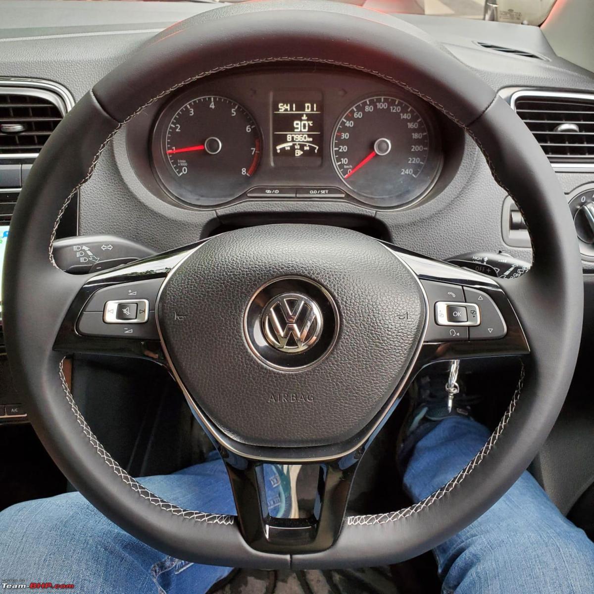

I also ordered a MFSW (multi function steering wheel) with the paddle shifters from Germany. While this wasn't really needed, it is surely nice to have:

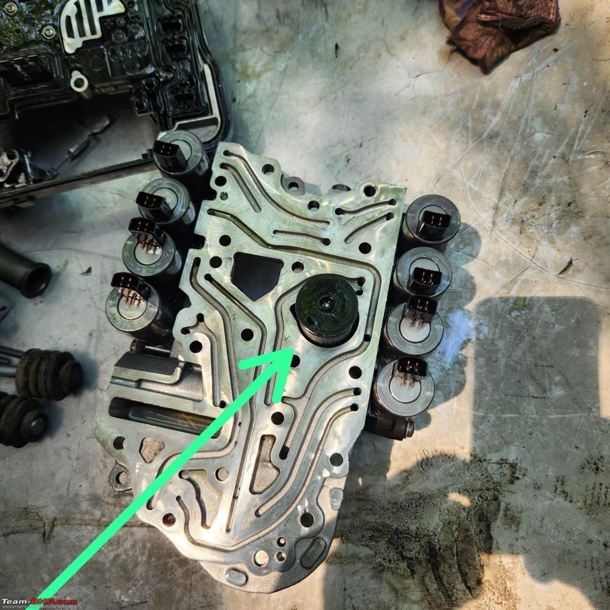

In mid April I got into the car to go to work and found that the mechatronic had given up. Got it towed to my shop the next day:
Given that I've done this more than a few times for customer cars, I wasn't too worried about the mechatronic. It just needed to be serviced and has a little known filter inside the valve body. My team got to work and dismantled the front clip (bumper, headlights, radiator, etc.) to access the mechatronic and also drained the gear and mechatronic fluids. The culprit is this small filter that gets choked and does not allow sufficient pressure build up to move the solenoids.
The process of dismantling, servicing, and fitting back though not super complex, is very time consuming.

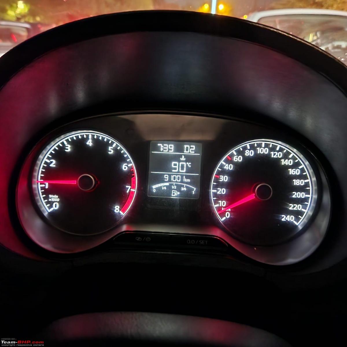

Current odo reading is a few hundred km more than this:
