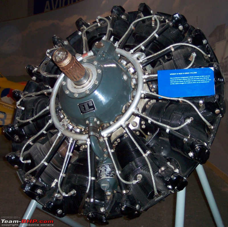

If you ever find yourself in an aviation museum, chances are there will be a Wright Cyclone 9. If you are lucky, it could be one of these cut-away ones. Have a good look. It is incredibly well-engineered (for its era of course)
There are dozens and dozens of different variants. Over its life span, it went from initially producing some 550HP to well over 1525HP in its latest version. This also meant it broke the magical 1-pound weight per 1 Horsepower ratio!!
Its official type designation is a single brown, radial, air-cooled, single-speed supercharger, 9 cylinders, compression ratio 6,8:1. Developing max horsepower at around 2800 RPM at sea level.

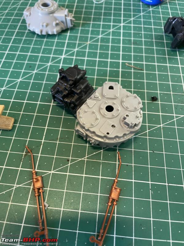

So I set off a few weeks ago and started assembling various bits
It is possible to build the model with one "cutaway" cylinder so you can see the piston. I chose not to do so.
Back to the horrible quality of the parts. Look at this!! These are the spark plug leads. They are made from a kind of very soft, flexible plastic. And you can see, they are not particularly well made either. What you see on the edges is usually the result of poorly made or worn moulds.
Nevertheless, we are making progress!
