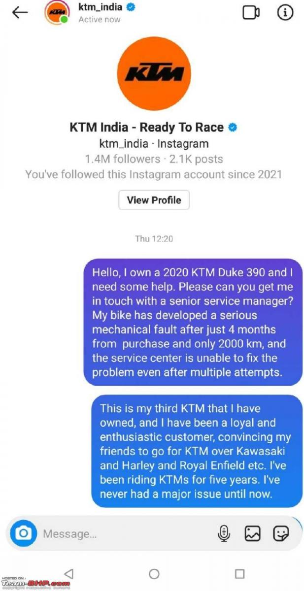

Now I'm a generally polite guy who doesn't like to make a fuss, so I really didn't want to opt for the "nuclear option" of taking to social media and shaming the company. So I opted for one last try by DMing them on their official Instagram. Explained the problem, they said they'd get back to me, and again, nothing happened after that.
