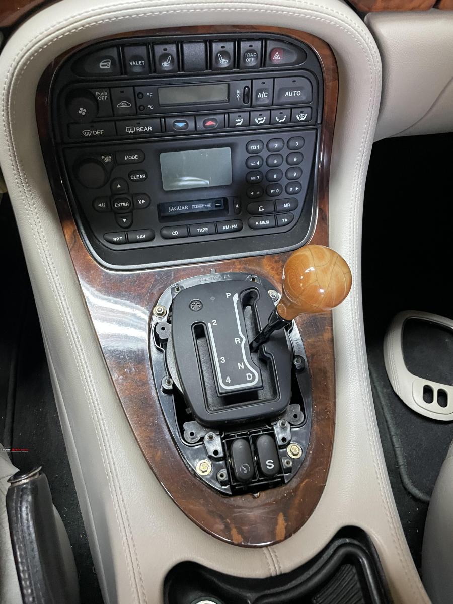

First thing is to move the gear lever out of P. It needs to be out of the way or you won’t be able to get other parts out. You need to have the ignition on to be able to move the lever. Once in the correct position, I switched off the ignition and also disconnected the battery.
In this image, the bezel surrounding the J-gate has already been removed. It just clicks into place. Two fingers on each side and you pry it off easily.

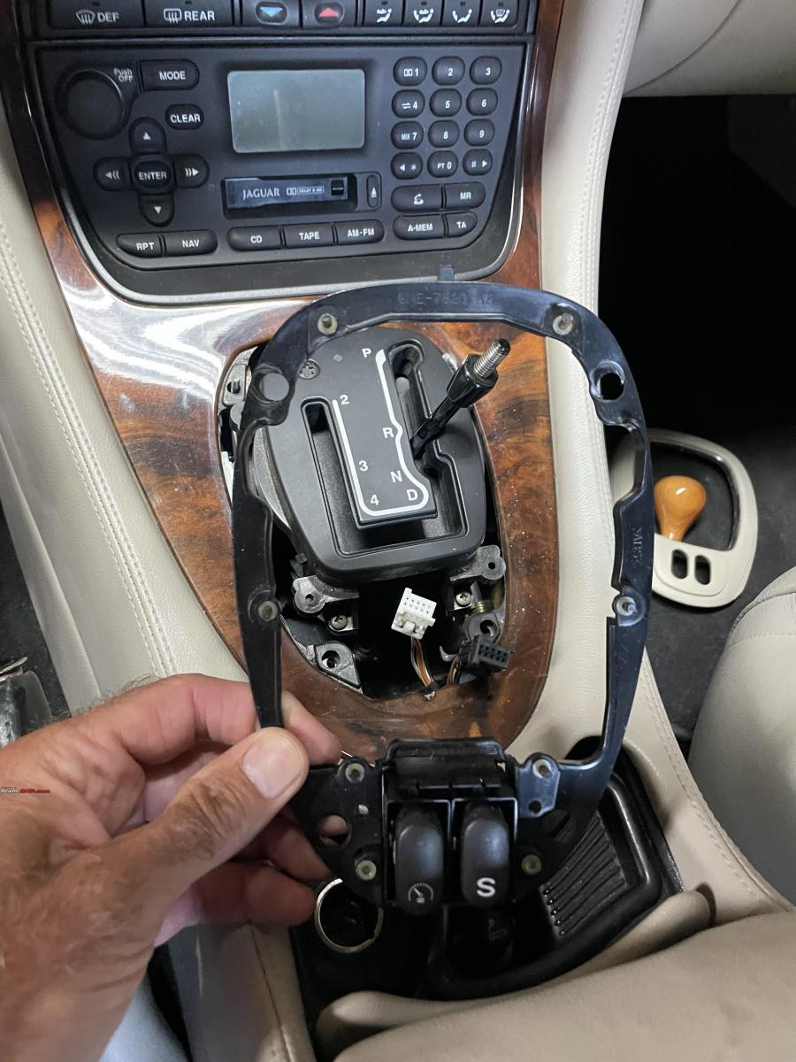

Next, undo 2 bolts and two nuts and the retainer plate comes off. Undo two electrical connectors for the cruise control and Sports mode. Also, remove the knob on the lever. In this case, it just screws off.

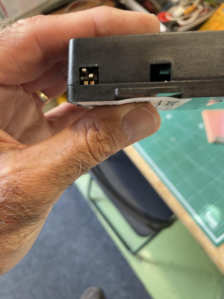

At the back of the FM modulator is a diagram showing how to set the different frequencies. Set with two small toggle switches.
Funnily enough, my radio has never been tuned into the frequency set! The idea is to find a frequency that is not in use and put it into your radio memory. As the modulator injects the signal directly into the aerial it is usually much stronger than any signal in the atmosphere. So interference tends to be a none problem.
But I also seem to recall that you could actually set the frequency to any value by means of a potentiometer or so.
So I disconnected the modulator and opened it up. My memory must have been wrong as there is nothing that can be adjusted other than the toggle switches.
So tried a different setting

I tried a few different settings of the toggle switches.

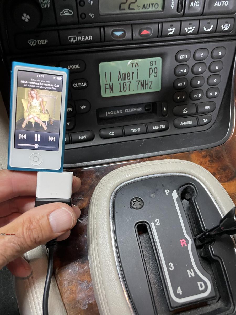

Tested each one with my iPods. Yes, I still have multiple iPods, on a 2002 Jaguar they are considered period. And I am a bit of a retro-tech nerd of course as well. So I tend to keep things like that.
I found that the system appeared to be working best on 107.7MHz. So that is how it is set up now and stored in my radio memory.
