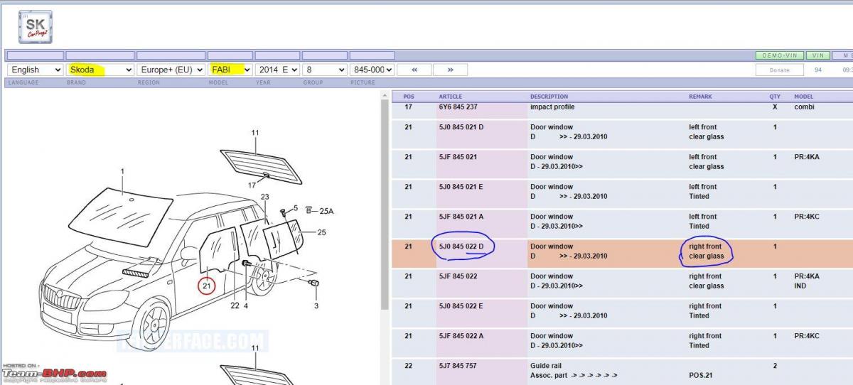

Upon reaching home, I looked into the billed part number using Dlinker ETKA, and to add insult to the injury, they charged me for the Skoda Fabia front right side glass while the replacement was done on the Skoda Rapid front left side glass. For comparison:
  • 5J0845022D - Fabia Front Right glass costs: Rs 3072
  • 6RU845201D - Rapid Front Left glass costs: Rs 1705
Picture 5: ETKA - Fabia Front Right glass part number
Picture 6: ETKA - Rapid Front Left glass part number
After informing the new SA regarding this, he told me to wait till the next day as it was day closing time. After collecting necessary proofs from ETKA, I contacted the new SA on March 2nd morning, and as expected, the new SA argued with me, stating that the part is a modified part. Since most of the parts are interchangeable, they made the Fabia glass fit in Rapid after calmly listening to this. I raised the question, "How in the world is a right glass from a smaller car modified to fit a left-side glass of a large vehicle?" Upon raising this, he lost his words. At this point, I am pretty sure they are trying to mess with me. I asked him to discuss this issue with his manager or someone from the parts department and get back, and after 2 hours, he called and apologized for the issue and offered me a deal on painting or some labor-intensive works, which I politely denied and demanded a refund and corrected bill. He was very hesitant initially, as this process requires approval from his general manager, but as I was determined to get the correct bill, he agreed to my demand.
