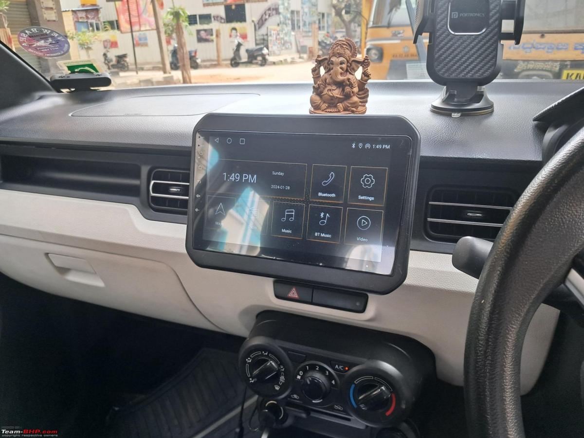

I decided to upgrade the old music system to an aftermarket Android Screen. I bought a Tesha 9" Android Screen from Amazon. It set me back by ₹8.5k and also bought a cheap aftermarket rearview parking camera for ₹650. The local garage near my home asked for ₹800 for an Android frame and another ₹800 for labour.
The Android screen came with all the necessary plug-and-play wires for sound, an additional microphone and a GPS unit. I could train the system to my steering-mounted switches. I listened to my favorite songs using the Music app with Android Auto on my drive back home. The rear camera view was grainy as expected. But it was an important utility to park in tight spots.

To my utter dismay, the navigation was not functioning properly. It would either take too long to update my position or there would be a sign stating "Searching for GPS". I was disappointed. Had to resort to the mobile and holder.
I had a doubt about the GPS unit and its position. The garage fellow installed it inside the dashboard. Doesn't the GPS antennae need to be exposed to get a signal?
Came back home and scoured through videos and blogs about these screens. Could not get a proper answer. All videos made by Indian content creators showed the GPS antenna mounted inside the dash. My brother also got the same screen installed on his VW Polo and his antenna was also inside the dash. Working perfectly fine. I was contemplating returning the unit for an exchange. But deep down, I did not want to return it. Did not want to go through the process of waiting for the exchange, return etc. Something told me, the GPS antenna was not getting a signal. I came across a South Asian content creator's video, which showed that the Android screen had a preloaded app, which could show the GPS signal strength.
App Name: GPS Track Plus
It showed around 4 GPS satellites and no strength bars. I straight away popped open the Android screen out of the dash. Removed the antenna and held it outside. The Satellite count increased to 10-12 and had a full bar of signal strength when I held it in my hand. But this immediately came down, when I kept the antenna on the dash.
I had a hunch! Maybe the antennae is weak and needs a better conductor to receive signals. Something metallic! I removed the beading on the driver side A pillar. Removed the plastic cover of the A-pillar. Stuck the GPS antenna on the A-pillar so that it comes in contact with the metal. Routed the GPS antenna wire inside the dash. Took extra care that the wire does not touch any other wire of the Android screen to avoid picking up noise.
With bated breath, opened the GPS signal APP. And Voila! The GPS worked. Full strength. Put back the cover and beading.
