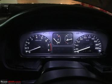

I also tried to change the bulbs in the instrument cluster to LED, managed to successfully do it but also found out that the check engine bulb was removed from the car.
LED instrument cluster
