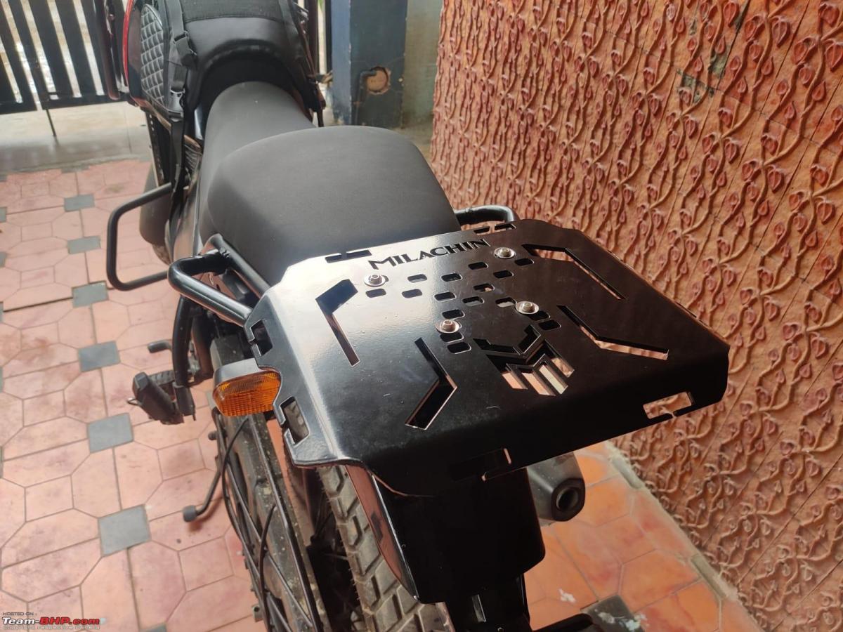

The kit comes with the plate, 4 x 4mm Allen Head Screws, 8 x washers and 4 rubber buffers. Fairly straightforward process to fix it and it took about 10 minutes. Here is the finished look:
Does not cover the tail light.
I don't think the product is powder coated and may be prone to scratches, but I will update in the long run. It is very sturdy and has dedicated slots to route a bungee cord/ROK Straps through and a ton of holes and a larger surface area to mount a top box onto which I've heard that they do require. Great product for my use case though. Until Next time folks, Cheers!
