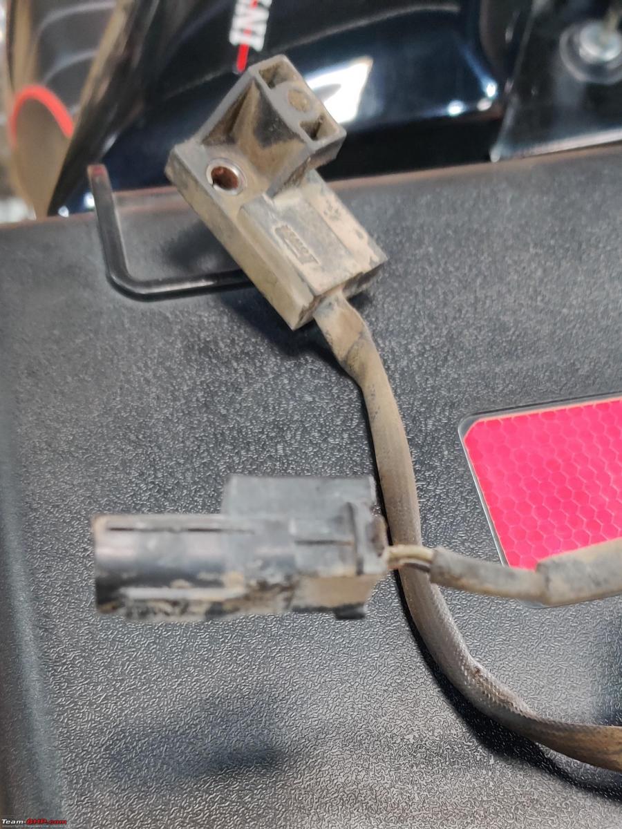

The sensor with a mind of its own.
The wiring went through the sprocket cover. You need to remove the gear lever, LHS footpeg assembly and the sprocket cover.
The coupler/connector on the RHS side. I was spraying contact cleaner on another connector!
Out comes the sensor.
No power! It's a magnetic proximity sensor. When the metal plate of the side stand inserts in the gap the sensor is closed (ON), when it works!
New sensor for 500 bucks, labour charged was 300 but I can't blame them. Don't go for DIY.
