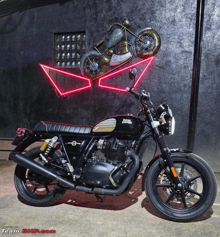

Interceptor 650 battery draining issue: I might have found the culprit
My 5-month-old Royal Enfield is on its third battery now and the only electrical accessory added to the motorcycle is the AUX light setup.
