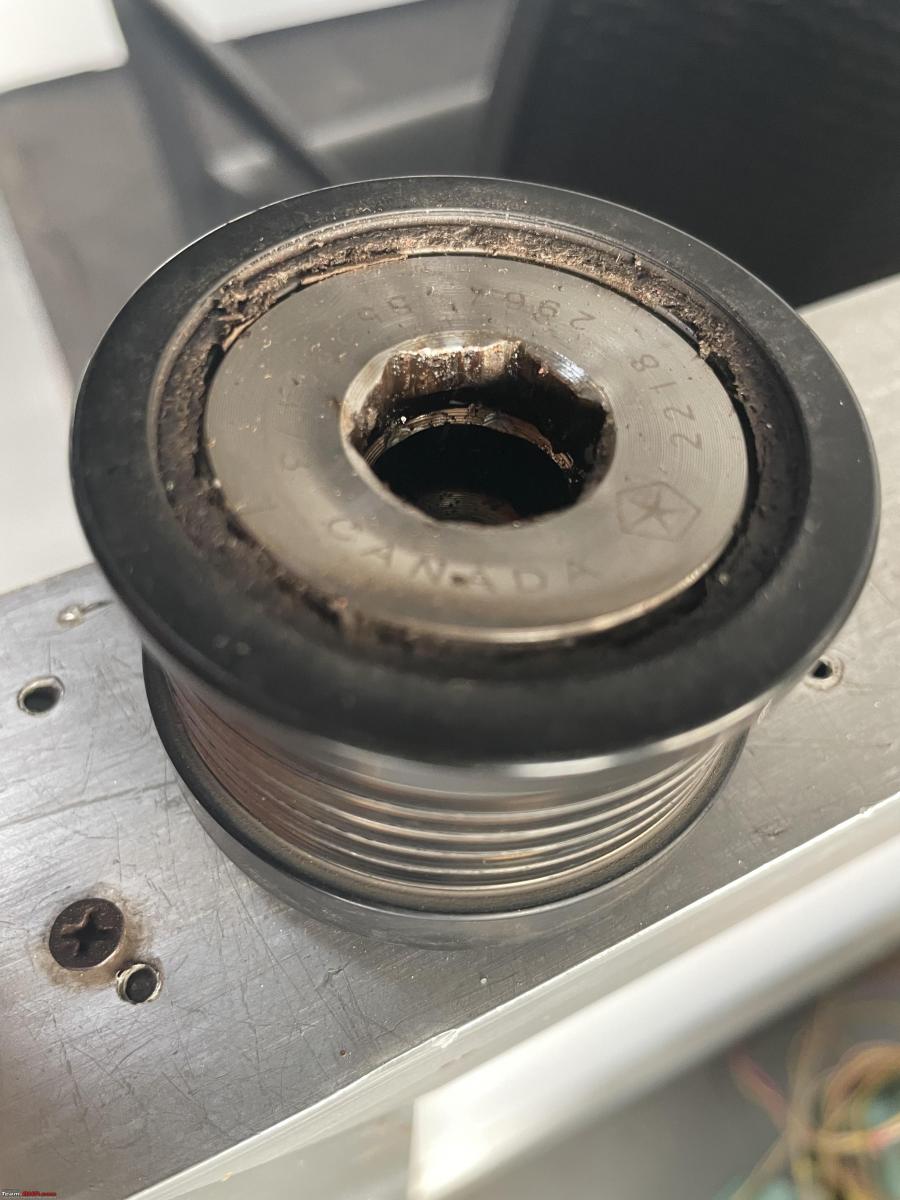

At around 11 am, 30 km before Tenkasi, the car a/c suddenly started blowing hot air. In a few seconds, other indicators started blinking and error messages for every part started showing up. I was perplexed for a moment as the car was serviced for the 30k mark just two days back at the Yashwanthpur ASC! My first thought was that the ECM was acting up and I cautiously steered the vehicle to the left of the road.
In another couple of seconds, the car stalled and even the steering got locked. The only message we were getting was to Service the VPS. I called up the RSA and they were quite efficient in getting the necessary details I was informed that a mechanic was being dispatched within 60 min. A mechanic turned up within the hour and after preliminarily checks hinted at a depleted battery. I was not very sure as a bad battery should not cause a running car to stall. Also, as per practice, I checked both the voltage and the DEF levels before starting the car in the morning. It had shown 14V that morning.
The local mechanic did not need to jump as the battery had regained enough juice by that time to crank on its own and was suggesting towing the car to his own garage. I desisted and sent him away. Anyways, the engine died within a couple of minutes again.
I again called up the RSA and they offered to tow the car back to the nearest ASC. My car was almost equidistant from Tirunelveli, Trivandrum and Madurai. But finally settled for Tirunelveli which was 80 km away. The flatbed arrived after a painful 4 hrs and then I flagged down a passing taxi and requested him to jump my battery using my own jumper cables. This was needed as I had put the auto lever on Park mode in those dying moments of battery charge in the morning. But to winch the car up the flatbed the lever had to be brought to Neutral mode.
Luckily, the taxi agreed and in no time I could jump the battery for a minute enough to shift the lever.
Meanwhile, my Bangalore ASC was in constant touch with their Tirunelveli counterparts. Between both service teams, it was almost concluded that the issue was with the Alternator assembly. Tirunelveli ASC confirmed that they have the necessary spares in stock if that indeed was the problem.
The RSA also offered a taxi drop to move us and our luggage for a max fare of 2k/- They could not arrange one immediately and requested us to book one locally and sent us the reimbursement form by mail. We got a local cab and proceeded for our balance holidays.
On Tue, after the Tirunelveli workshop opened after a couple of holidays, they immediately looked at the car. As expected, the Alternator pulley was found to be corroded. Being under an extended warranty, they changed the part, collaborated with the Bangalore team for the necessary paperwork and called me around 1 pm to inform me that the car was test driven and was ready for delivery.

Coming to your question, The part shown in your pictures is a decoupler pulley. My friend experienced a similar kind of battery discharge alert in his Compass, although the Odo was much higher, I understood this as an issue of the Compass in general. We discussed this with the Sky Moto technician at that time in detail regarding this battery drain issue.
My understanding is that Decouplers are extremely reliable. The biggest reason for a failing decoupler could be the engine resonance, more precisely the Idle resonance vibrations (The reason for resonance could be many, most predictable are calibration and driving behaviour).
To answer your first question- If the parts (alternator assembly) are working fine at ASC during service, the ASC can not do anything about it. No checking will help as the part is functioning properly anyways. The part failed subsequently because of the prolonged resonance (or fatigue) it is experiencing.
Do you have more pictures of the part? These parts come with a cap attached to them to save guard from the external environment, I could not see the cap so I am guessing if the cap is installed or not.
