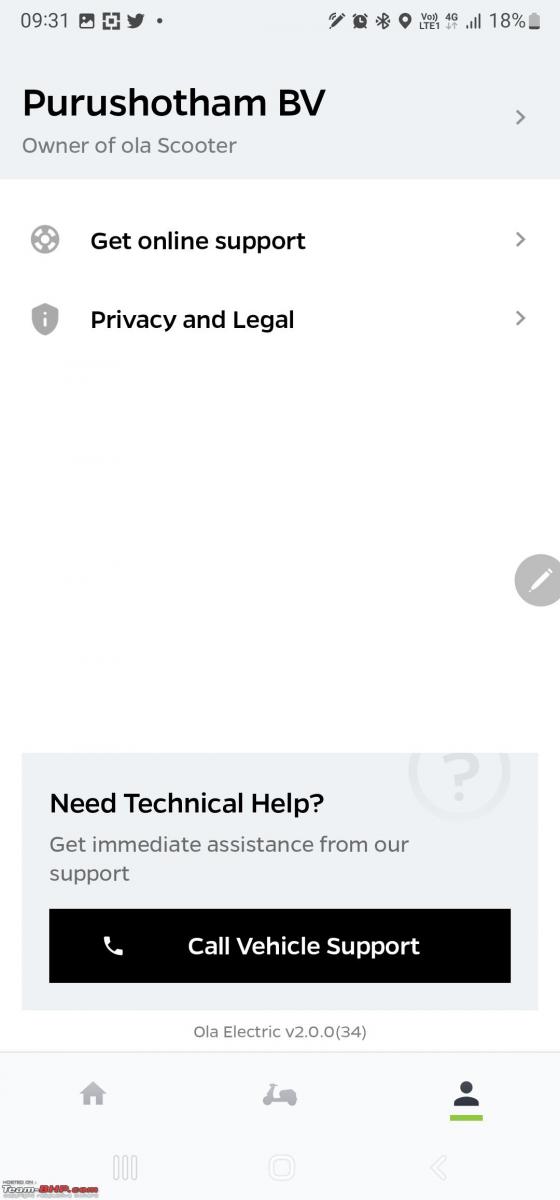

Received Move OS 2.0 update today morning, it's about 800MB & took 2 minutes to download. Installation took about 20-25 minutes and during this time, you cannot operate the scooter. You need to download the "Ola Electric" app and then connect to the scooter through Bluetooth.
Played music through the phone, and it was loud & okayish music quality. The navigation through Map my India & tried this to my office. First, it showed the route correctly, however during the ride most of the time it was showing "searching GPS". Did not try Cruise control. The app shows charging or not, battery status, km run, range in different modes, scooter manual, helpdesk etc
Bugs found in 2 hours:
  1. When unlocked through the app, the screen displayed parking mode but the scooter handle was locked. Had to switch it off manually & the did unlock through the app, the handle was unlocked. The issue did not recur.
  2. Morning I had charged the scooter & when I came to the office & locked the scooter, the app was showing the scooter is charging, however, this went off after a few minutes.
  3. Navigation was showing GPS searching many times and was connecting in between.
