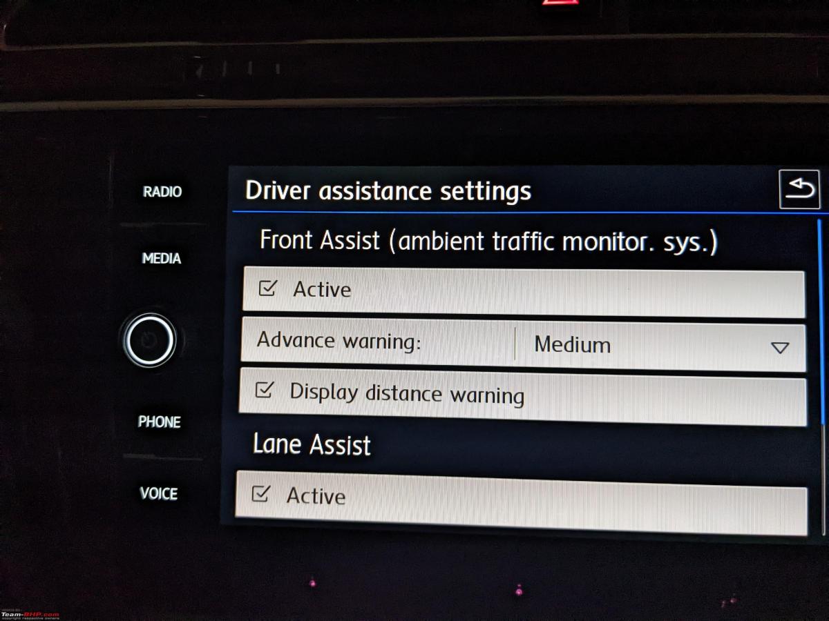

Adaptive Cruise Control
This was what it all started with. My quest for enabling ACC, which already has the necessary hardware. The modder gave me an option to switch to a new steering wheel (sporty VW) vs swapping the ACC switch piece on my existing one. Considering the extra 40k price hit, I went for the switch swap. As he inspected the car, also suggested upgrading the radar module, the stock module could only support up to 150kmph, while the new one could do 220kmph. And since the 3rd generation Driving Assist Systems that Tiguan Allspace has, comes with dynamic calibration, swapping out the radar won't create any issues. For the uninitiated, the radar module hides behind the ceramic VW logo on the front grill.
This was the easy part. The next part involved opening the steering and swapping out the ACC buttons.
This was a tricky process, unlocking the steering from the base, then opening it, and swapping the switches. Was a nervous 90-mins or so. Once this was done, our guy plugged into the CAN port and started coding, after another 60mins or so, installed the license, calibrated everything and it was good to go.
The whole mod affair took almost a full day, and mostly the delay was because of some lack of planning. The car was in our apartment basement, we needed to get it into an open, well-lit place to be able to work on. Then we realized we needed a good internet connection and a power point to connect the laptop. Downloading and backing up the entire firmware took a lot of time, with choppy mobile data and connection drop off. We started in the morning, but the car was ready to be coded only by 6pm. Eventually, everything got done by 1am. Lesson learnt.

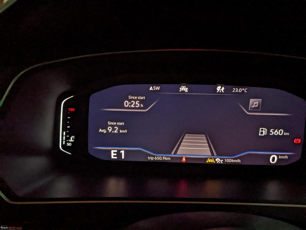

Look how the speed is going down as the car in front comes closer.

ACC took maybe around 30 mins to get used to, after that it was bliss! It was almost surreal to the car working its way through the highway with ACC and lane assist. In the beginning, your muscle memory does not let you let the car take control, but over a period you start trusting the car for slowing down and speeding up. [NEVER EVER took this lightly, was still alert all the time].
From Chennai, the next day we went to Trivandrum (another night drive). Along this 1000km+ in the 48 hours, we drove mostly using ACC, and maybe 2-3 times car switched to emergency braking instead of following the vehicle on front. I got a little scared, then realized, at night when there is a truck with no rear lights or even reflectors, the car was not considering it as a vehicle but an obstacle (this is my inference).
The biggest change in the driving post ACC was, we did not drive beyond 90kmph, but still had a very high average speed (55-65). Overall, we were reaching destinations faster, even though the overall drive was relaxed. I was told ACC would bring down mileage, but I attained never been seen mileage ranges post the mod.
