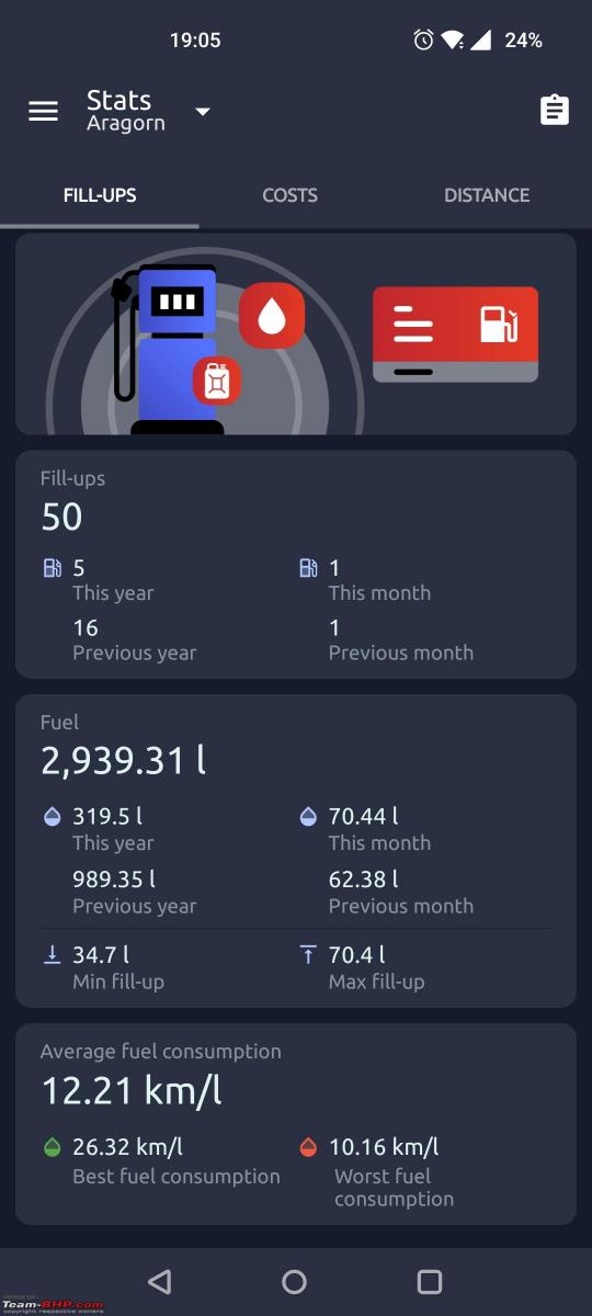

Fuelio informs me that I've consumed a lot of diesel and spent a lot of money on service.
This is the cost inclusive of fuel and service. Not bad in my estimation for a heavy automatic vehicle. All in all, owning and maintaining a Mahindra has been quite reasonable.
That number of 26, I'm not sure, why Fuelio is showing me that however, I don't think I've managed more than 16 KMPL ever.
