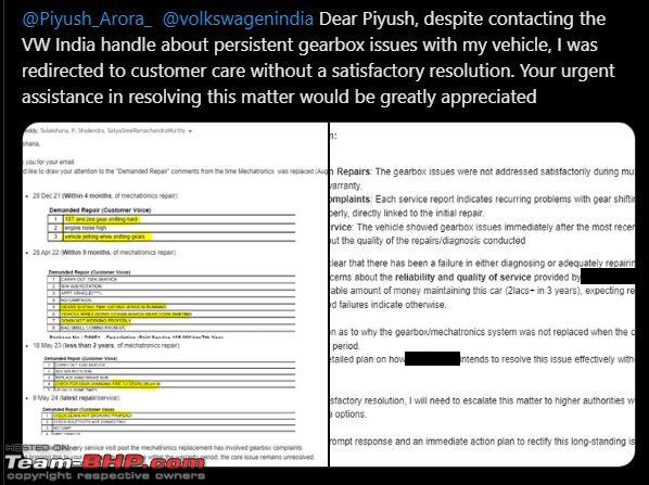

Now, 2 weeks ago, the vehicle was getting stuck in the first gear and wasn't drive-worthy, so I sent it for repair. The service center does some checks, they say it is all fine, they also do regular servicing, and send the vehicle back. The next day, the gear gets stuck again! I reported it back to the service advisor and he suggested that I should get the replacement done for the mechatronics/gearbox. I wrote to the customer care of Volkswagen India on their website for help as I was not ready to bear such a huge expense out of pocket - The service manager from the Hyderabad dealership called me and tried to understand the issue and then I was sent this email -
So they offered me an amazing 10% discount out of some great goodwill they have. I responded back to them asking for invoices from all the service/repair work done in the last 3 years. They responded back with the invoices after one week! (this too after copying dealer principal only). So, I sent this email two days ago and there hasn't been any response to it yet:
After receiving no acknowledgement or response from them. I wrote to VW India's Twitter handle, a DM copying the content of this email and they sent a response back saying Customer Care will contact me. I clearly said I was looking for escalation contact, but they did not provide one. So, I tweeted to the CEO of Volks India, Piyush Arora, copying VW India.
So, this is where I am right now. I would like to hear from this forum on what would be a good way to proceed from here. Should I take legal recourse? Should I tweet to VW Global, will that help? What are the chances that the dealership will replace the part without any cost considering this as a special case? Appreciate any advice in this context. Thanks!

Heard back from the dealership. I received a call back from their CRM. She told me that the dealership was notified by VW's social media desk. She then asked me if I would be ok with the offer they gave me (10% discount for repair). I asked her why should I be ok with it, esp after the failure to make it right every time they had an opportunity to do so. To this question, she mentioned that they had delivered the vehicle to my satisfaction on every instance of repair and I accepted the vehicle post-repair.
To this, I said that if the said fix was done to my satisfaction, why was I sending the vehicle back within a few months again with the same issue? She then says that she doesn't have the technical background to answer that question. So, I said, as a customer I wouldn't also know if the issue was technically fixed or not except for evaluating it in working and if it didn't work within a few weeks or months, then it hasn't been fixed correctly - that's my evaluation.
I also mentioned how the invoices contain my concerns, but they don't go to the technical details or commentary of what was done by the service advisor clearly, except line item billing, so there is no way to tell what has been fixed, other than taking their word for it.
I added that in this whole process, the dealership seems to be thinking that this is some sort of money problem and thinking it can be solved by offering a discount. The real issue is that the dealership is not able to come back to me with the root cause of why such lapses happened over the years. And this is what, I have an issue with. I would expect answers like .. 'the part is known to failure - it is VW's fault', OR 'the dealership was at fault for not fixing it right', OR maybe 'you didn't drive the car right'. If all I get offered is some sort of discount, I am not interested in it.
So, she asked me what was I willing to pay - I said I will not pay for a part that has such a high failure rate/reliability issues and VW/dealership has to account for it. If it is a VW quality issue, I expect the dealer to stand by my side and take this up with higher authorities on the VW side and make it case for an exception to get a new part without my burden.
I have always gotten it serviced from their workshop and I spent probably 4-5 lacs in all these years on the car, so they owe me that much. If it is their issue, not VW's issue then they have to fix it on their own. If neither is going to happen, I will settle this in the court of law and I've already discussed this with my lawyer.
After this discussion, she said she would arrange a call with somebody from VW on Monday. I will update this thread on how it goes after this call happens.
