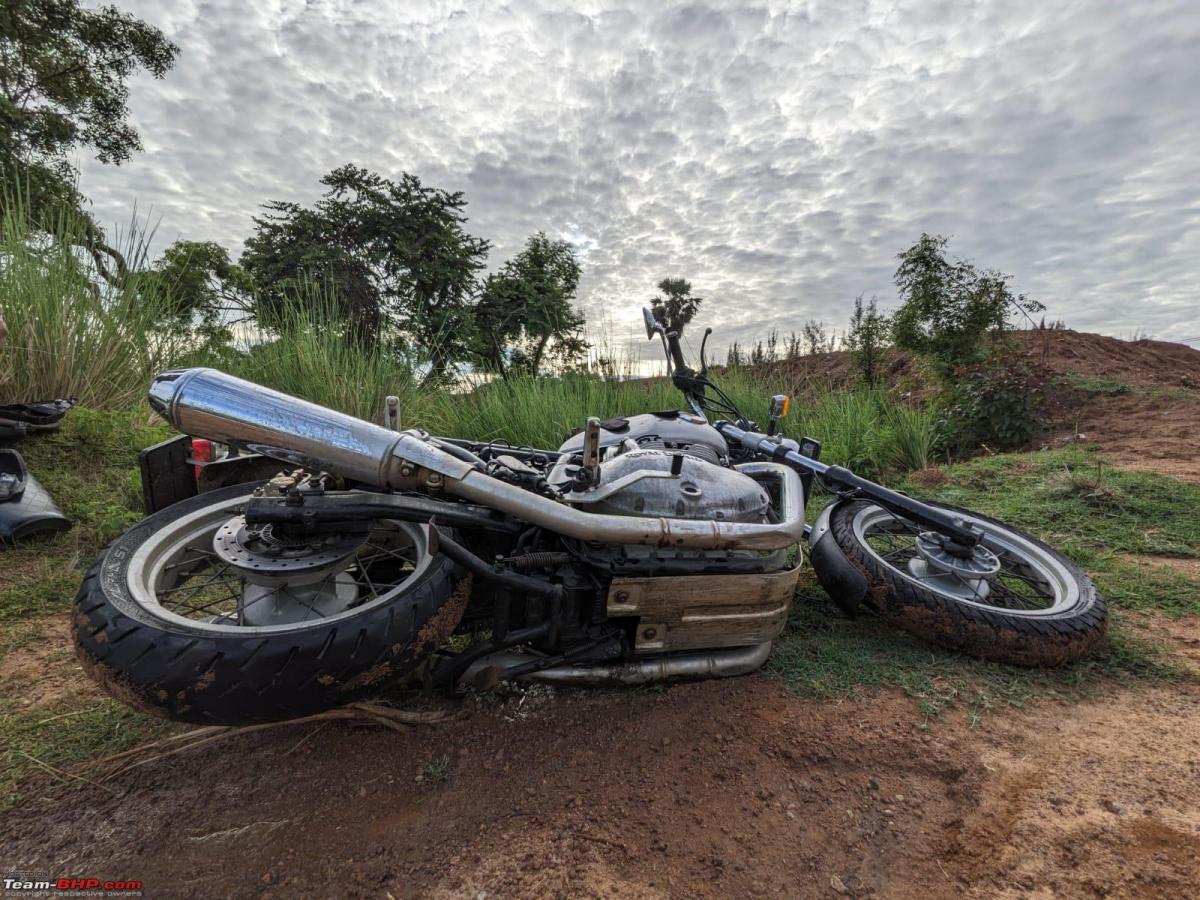

At this point seeing the water out of the silencers, I thought the worst was over until we laid the bike on the left side to see water dripping out of the air filter box. I feared of water entering the combustion chamber through the air filter and mixing with the engine oil.

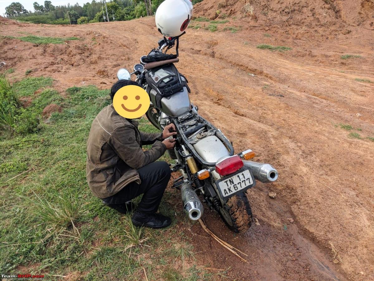

Removed, cleaned and dried the battery, relays, fuses, air filter and spark plugs under the sun at the lake. Pushed the bike in gear from the top of an incline and could see water droplets spraying out of the spark plug holes so tried pushing the bike a few more times to get the water out. The engine oil looked fine through the inspection window.

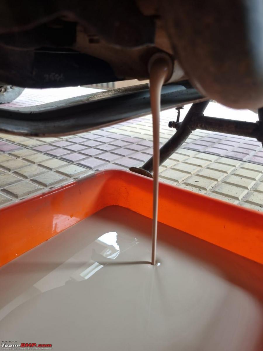

After letting the bike dry for nearly an hour we reassembled the parts and the bike started in the first crank. Let the bike idle for a couple of minutes and rode back home at a steady pace. The bike behaved fine all the way back home. Once back home, checked the inspection window again only to face my worst fear, water had mixed with the oil and the engine oil looked white in color.

Noticed water dripping out of the air filter cover.
Fortunately, the Meteor 350's tool kit had the spark plug deep wrench tool.

That's how the oil came down at the start of the drain.
That's how the oil was at the midway and towards the end.
