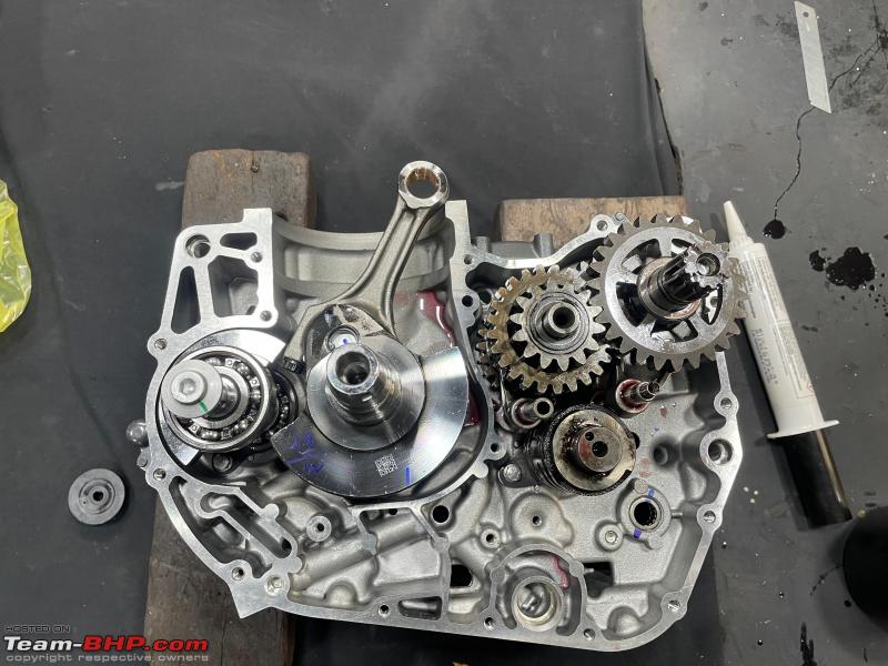

After 11 years and 37 thousand kilometres Tali gets a brand-new heart, total time taken including ordering parts, delays and testing it took around 4 months to complete. Post the rebuild and almost 1000 kilometres, the engine feels more smoother, responsive and there is minimal strain while taking a pillion.
Fresh new engine
All the fresh parts been laid out.

The remains of the previous engine
Final checks

So 90% of the engine is new except for the gearbox, all the parts which went into this build are from the BS6 engine. The break in period was 1000 kms and running Silkolene 10W50 and keeping it under 7000 R.P.Ms, it sure wasn’t an easy task, but for a good engine health for the future kept it under control 90% of the time, the bike felt responsive even under 7k and addictive.
