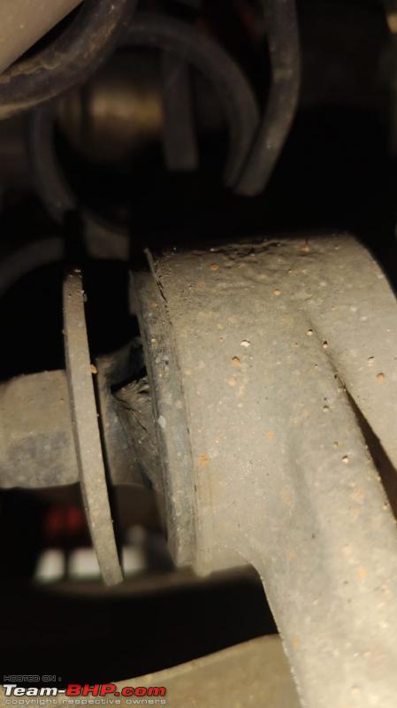

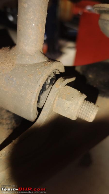

During a recent wheel alignment, my regular Tyre guy brought to my attention that the control arm bushes have deteriorated and the rubber in the bush has cracked due to aging. Not that it made any difference to the driving (shows how damn well built the Hexa is)

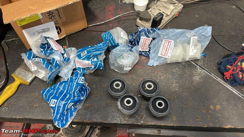

  • Procured all the parts ( all bushes ) for 6K

All the control arm and balancer rod bushes were procured OEM @ 6000/-

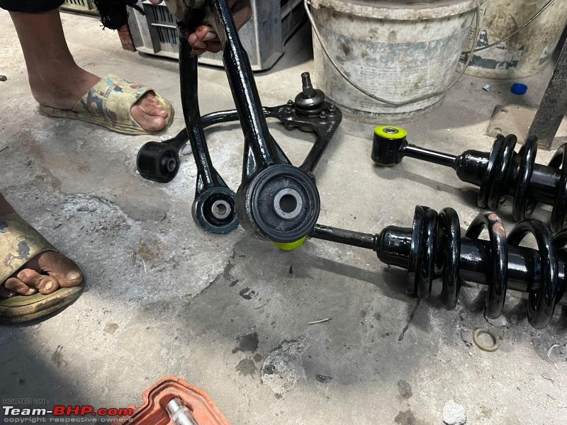

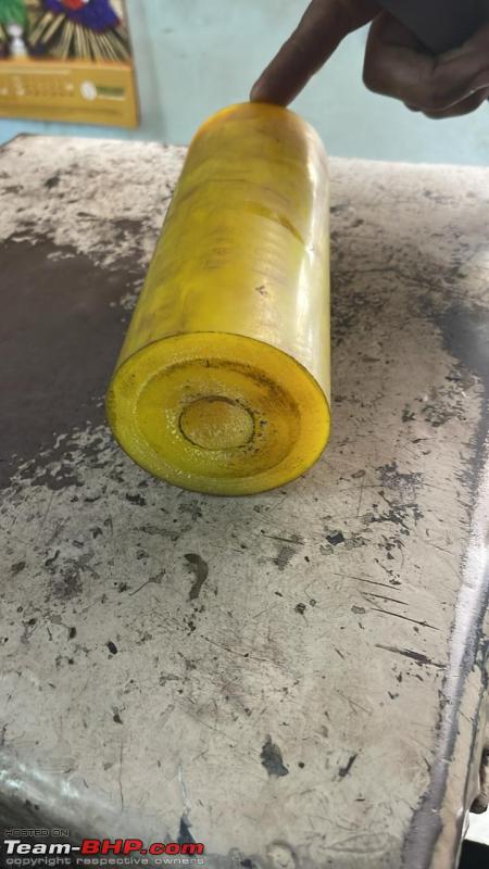

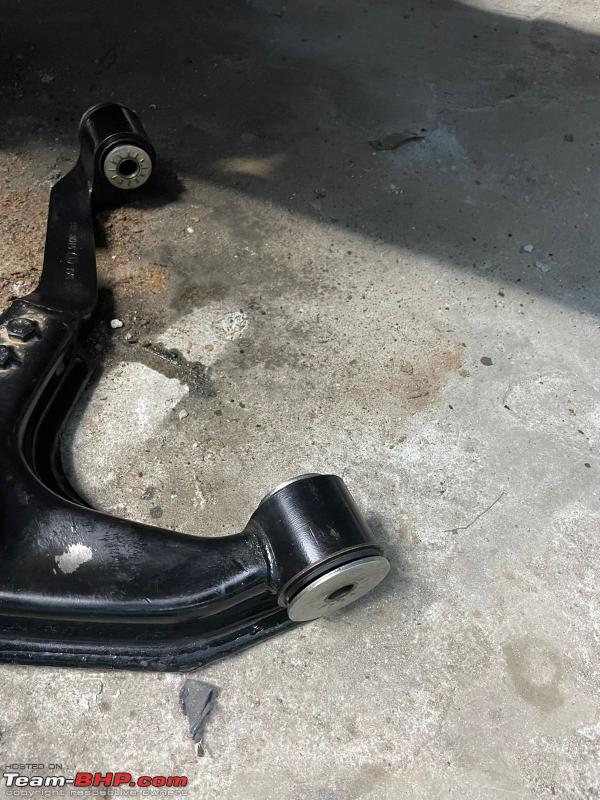

The rear suspension bushes are not sold separately and need to be procured as a whole set. The suspension mechanic checked the same and confirmed the supension and springs are is great condition, so we took it to the lathe person who had Polyurethane Bushes. These are a great aftermarket alternate and offer superior performance compared to the regular bushes. The life expectancy is also very high.
Finally all the metal parts were diesel washed and fitted back followed by a manual wheel alignment, let the pictures do the talking.
