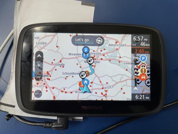

Moment of truth:
Power on, and the TomTom rebooted immediately!
Very happy with that. I am charging it for a couple of hours with a regular charger. Looks like a job well done.
