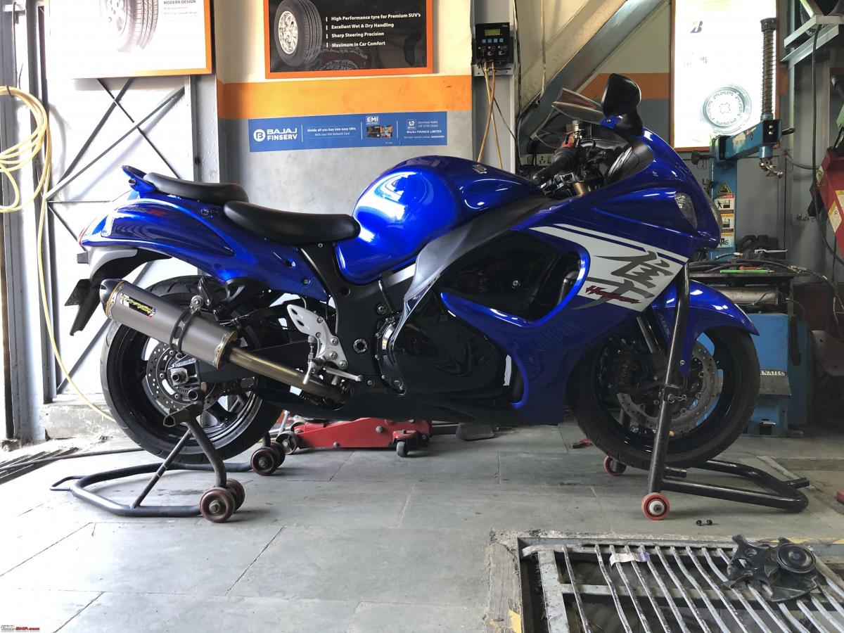

The horn and plastic covering near the bottom of the front fork T bracket need to be taken out to fit the front paddock.

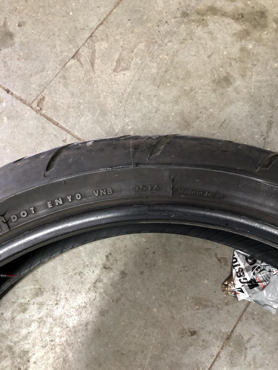

Showing its age as the made in Japan rubber had gone quite hard.

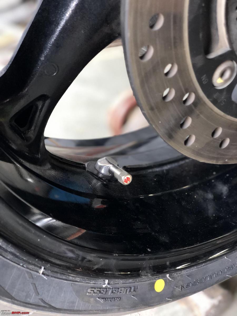

Since I had to change the valves too I got these 90-degree valve stem adapters installed. 1100 for a set + GST and I was told they come from Bangalore. MotoUsher also sells something similar (design-wise) online which is made by WUNDERLICH and retails for 1150 for a single piece.

Moving on to the front tyre. Brake calipers, front mud-guard need to be removed from their usual mounting position to take the wheel off.
Both the wheels were balanced.
10,034 km is how long the old rubber was on the bike.
The OE Bridgestone Battlax was manufactured in Aug 2016.
