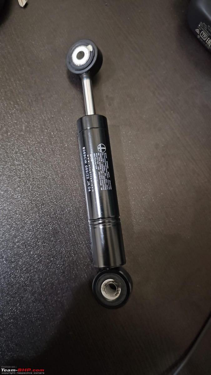

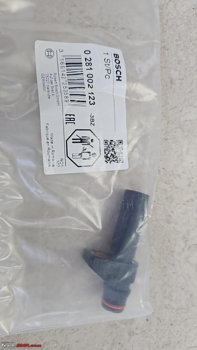

Even though OM605 is a non-complicated NA diesel, the parts which may prevent the engine from starting are the fuel shut-off valve, crankshaft position sensor, air in the system due to worn O rings and Diesel plunger spring. So, as a precautionary measure, I replaced it altogether with the fuel shut off valve. The V belt had a noise in the idle RPM. So, replaced the damper and spring. Now, the engine runs very smoothly at idle. Planning to fix new diesel injection nozzles too.

Tensioner
Crankshaft position sensor
