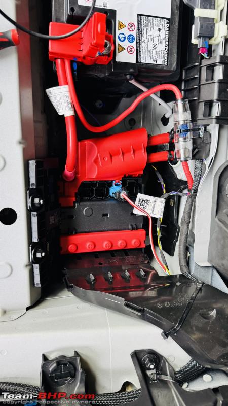

We finalized a date for the installation and blocked a timeslot for the same. The installation itself was fairly straightforward - the DSP needs power, which was tapped from the battery. The workmanship and attention to detail was really good. The first thing they did was hook up a battery charger to ensure the battery was topped up. I enjoyed watching them go about measuring the power wire, sheathing it and then using a heat shrink on the terminals before piping it under the frame support. Everything was neatly cable tied and one would only know the battery was tapped by looking at the massive fuse coming out of the battery +ve terminal.

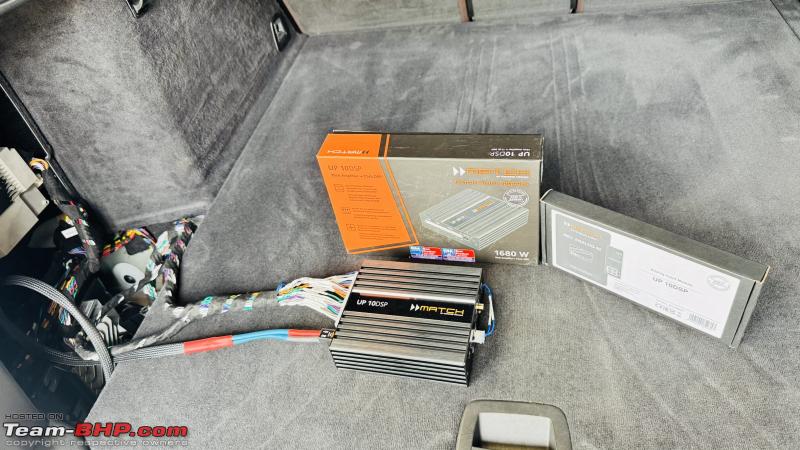

Match UP 10 DSP

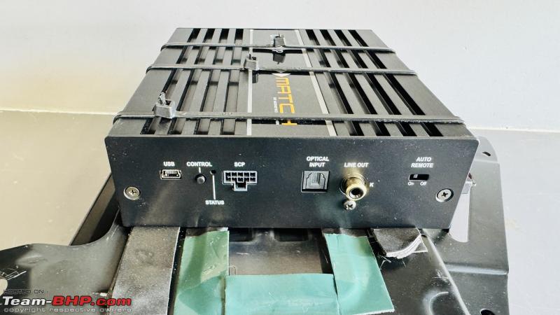

Mounted behind the Receiver Audio Module

Power wires connected, can see the huge bulb-like thing from the positive terminal
Close up of power cable
