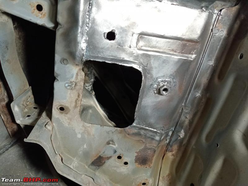

  • Last bit of rotten bodywork is patched. The rotten bit below the battery tray is patched for good. (You can see this previous post where it's clearly visible). This finally concludes the bodywork to be done to the car.
Here's what it looks like now from up top:
The view from down below:
