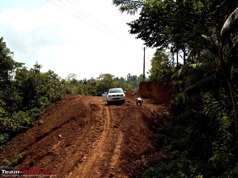

  2. In a GV photography trip with Rudra, we had to turn back when the road got too rocky for the underbelly.

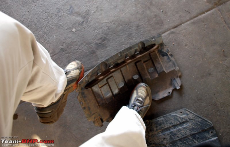

Recently the toughness of GV stock skid plates has been a topic of hot debate. The GV has only 3 plastic skid plates as shown below.
I could bend it using my leg and shoot it at the same time.
Now, I am not at all technical about cars. Until I joined Team-BHP 3 years back, I had never tried to mod any car I owned. Even after joined Team-BHP, I only did modifications that I could understand. Considering my limited automotive knowledge, it never went beyond changing tyres or air filter. So I figured I can do the same with skid plates, buy them and fit them. But it was not so simple this time. Nobody sells off-roading accessories in India, and especially not for Grand Vitara. My research found vendors in Europe and Australia who made skid plates specific to current generation of Grand Vitara. To my surprise, I found that even USA and Canadian GV owners didn’t have ready access to GV skid plates. One Israeli company gave me a quote of US$1400 for shipping it to India, and there is customs duties in addition making it prohibitively expensive. I didn’t get any response from the others; they didn’t want to bother with international shipping.

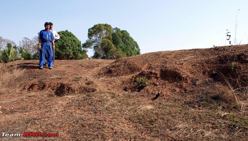

Last Saturday they were finally ready with all the skid plates, for field testing. Finally, it was time for me to show the designers what the product was supposed to do. I took both Mr.Kamath and Mr.Ramachandra to my office grounds where I had a pretty good off-roading site. This is the same place where we off-road tested the Gurkha. As I chose the off-road obstacle to test the skid plates, I saw a strange expression on both their faces, and I suddenly realised that they have never seen off-roading of this kind.
All this time they were thinking of roads with rocks or big potholes and not the sport of off-roading.
Notice the normal gap in the front wheel arch.
The front skid plate hits the obstacle, see the wheel arch gap increase.
Now the middle part hits the obstacle, see the wheel arch go up again, it could have been the transfer case.
I climbed the obstacle in 4L easily and they were quite mesmerized at how easy it was in the end. The underbody banged the ground as expected at couple of spots. Mr.Ramachandra was closely watching which parts hit the ground, all of them were on the skid plates and at well supported places.

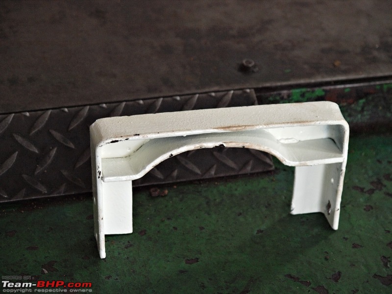

Here are the parts before installation.
Brackets:

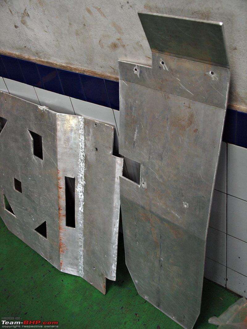

Plates:
If you are wondering how heavy these are, check this out. I am lifting the biggest skid plate with two fingers of my left hand, while shooting the photo with the heavy E3 in the other hand.

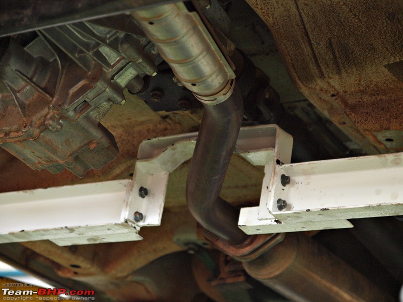

The brackets are getting mounted. None of these bracket bear any load, expect the last one.

The bolts are tightened with torque wrench.
