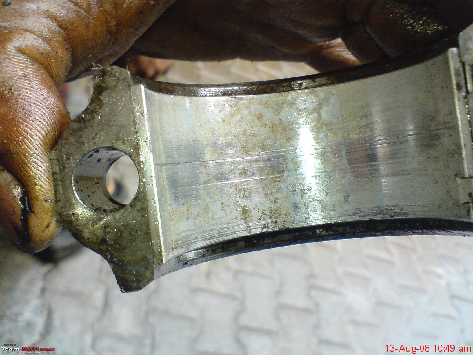

Morning I had asked the Service advisor for a full engine check.
I got this email from the Service Advisor in the evening:
Dear sir ,
we got the cylinder head & fixing it out in best possible way . i opened the crank case & removed one of connecting rod bed , while inspecting it is clear that the engine is overhauled once . the 1st over size connecting bed found in the engine , so it is overhauled once. and it is found that the job is not done in perfect way . we check the play of all connecting bed it is found ok and we tested for connect rod bend by the way mr behram suggested . i think it is not necessory to overhaul the engine now itself . i am sending a photo of that connecting bed with bearing .
When I talked to him later, he told me that the next overhaul is not required at least for 40,000 Kms. Therefore no other engine work needed for a long time.
The photo he sent:

He said he will weld only under owner's risk and won't take any responsibility for this work.
Quite rightly so. On (double wall) castings welding is not going to work with any degree of reliability. COLD repair is required.
The process is called Metalocking. Please check if there is someone in India that would do this.
End of the day, it might not be cost-effective in our country.
And, BTW, form that photo of the bearing, I would recommend that the central grooves be manually etched deeper to ensure oil retention.
