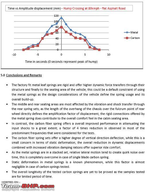

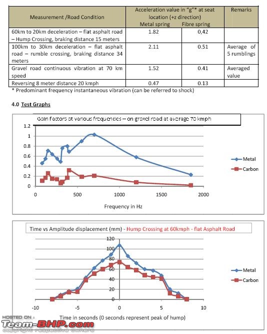

Here is a test report that was sent to me by email by the company. They tested some parameters on both metal springs & composite springs on a Ford Endeavor.
Case study on Carbon Fibre spring suspension for FORD ENDEVOUR THUNDER.pdf
Am sharing it here to get views on how this would translate to off-road situations -- especially where not just lateral flex but rotational flex during articulation would be induced.
Here is a image of page showing some figures
Composite Fibre Leaf Springs: Can they be used for off-roading?-fiber_tests.jpg
Composite Fibre Leaf Springs: Can they be used for off-roading?-carbon_tests2.jpg

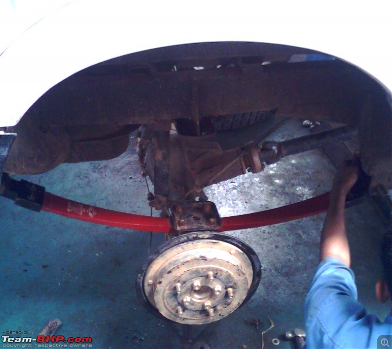

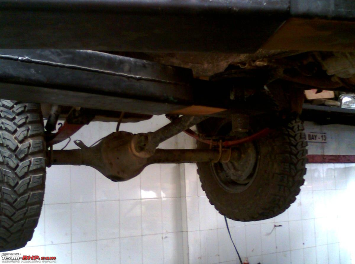

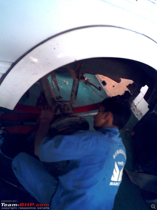

I got the composite leaf springs installed today in my Gypsy. Will test them out thoroughly in the next few weeks/months in all types of conditons.
Let's see how they perform on a SPoA setup. The camber seems more than stock and the Gypsy is raised by ~1" in the rear now.
Here are some pictures of the install
Composite Fibre Leaf Springs: Can they be used for off-roading?-img0061a.jpg
Composite Fibre Leaf Springs: Can they be used for off-roading?-img0063a.jpg
Composite Fibre Leaf Springs: Can they be used for off-roading?-img0066a.jpg
Composite Fibre Leaf Springs: Can they be used for off-roading?-img0065a.jpg
Composite Fibre Leaf Springs: Can they be used for off-roading?-img0071a.jpg
Hoo boy! You are one enthusiastic guy man! Hope you like the difference in ride. You may need to fit a bam bar though!

Thanks Jyobeb:). What's "bam bar" and what does it do?
BTW, I am waiting for feedback from you also on your composite leafs. especially that you also have SPoA now on the jeep.
Looks like this thread is being instrumental in lot of queries and takers for the CFLS.
I am sure the ride is going to be better if those stats are true.
Also strange that they have issues with it being used in the front? Any idea what are the issues they are facing?
The traction bar/ bam bar prevents axle wrap which is usually a negative effect of an SPOA conversion.
