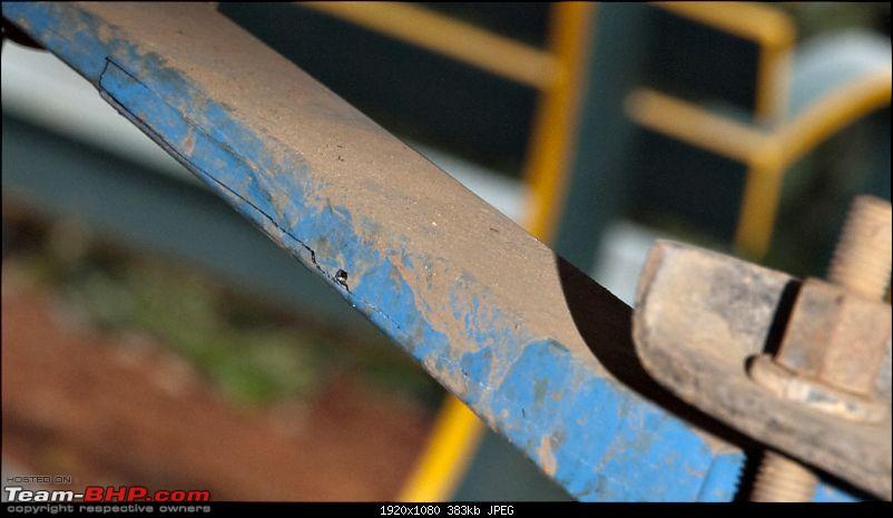

Here is what happened to the front set in the OTR @ kakabe.
Composite Fibre Leaf Springs: Can they be used for off-roading?-pc223839.jpg
Composite Fibre Leaf Springs: Can they be used for off-roading?-pc223841.jpg
Because of the design flaw, one of them broke like a pencil and the other had started shearing/breaking. It was a moment filled with disbelief as I never thought that they would break -- that too like this.
These were part of R&D sets and I had them for trail basis, so not to worry too much as I knew I could still drive slowly & had fellow friends along for help. The fact that I had SPoA also helped because the gap between the wheel & body was enough to ensure that the body did not sit on the wheel. BUT, if someone were alone, then it would not be a nice situation to be in. Also, in a stock Gypsy, the body would have just sat down on the wheel, scraping it big time, and the vehicle would not even move... So a not so nice situation to be in if this breaks.
Somehow, but strange stroke of luck, I managed to get NEW model front CFL in Virajpet from a fellow off-roader/Gypsy owner who had put these just few days back. After seeing my broken one's he offered my his front CFL's and he got the metal one's back in his Gypsy. (Thanks a lot Dr. You were a savior that day.)
Now I have driven some 200 Kms after that (ONLY on highway). There is marked difference in the BLUE ones and the RED one. This set is lot lot better BUT we need to test it over time for stress & fatigue..
For now, even though I am running them on the front, I would not recommend them to anyone. Use them at your own risk for now....

My 2 cents on why they broke:
I shall stick to my OE sets all around!
The rear CFLs have been around for many years now, don't let the front CFLs affect your feelings on rear CFL. They undergo very different stress compared to the rear. The front CFLs are experimental as of now.

Deepak, yes, it's a scary scene. As I mentioned before these broke because the design flaw made them behave like a rigid rod. And they broke.. What I should have done is observed them with magnifying glasses regularly for evidence of fatigue/stress fractures.
  • The design flaw of the mounting points did not allow any flex with stock shackles. That meant all stress/fatigue being transferred to them and they behaving like a rigid rod.

With the BLUE one's, the ride was HORRIBLE and imagine getting a death wobble in a Gypsy even on the slightest undulations -- forget bad roads/speed-humps. I think, I did mention that in my earlier reports of front CFL experience
However, with the new RED set, the ride & handling is way way better -- like day/night difference. Has to be time tested now with an eagle eye.
