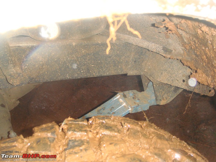

I guess I spoke tooo soon :Frustrati. I broke the 3rd set this weekend in the Sowmerpet trail.
The front left leaf broke/snapped at the point where the rear joint is. I was reversing the tyre over a 2ft boulder and it could not take the compression (-ve compression force) applied. I don't know if the -ve camber ability of these is adequate. Also, once the front left broke, the front right also could not take load and started splintering.
Here are some pictures.

Khanbhai, If I remember rightly, all three front CFL which cracked are rightside. Am I correct? could there be any other reason like front right body structure? Just a layman's mind you know?

Khan Saab, was there any similarity in the failure mode of the 3 broken CFL's (region where it broke, nature of breakage, did it start with a hairline crack etc). Can you post pics of the 3 failures side by side, it would be interesting if we could come out with something:). Any special observations from your side on when it actually failed in these three occasions?
