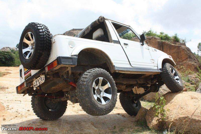

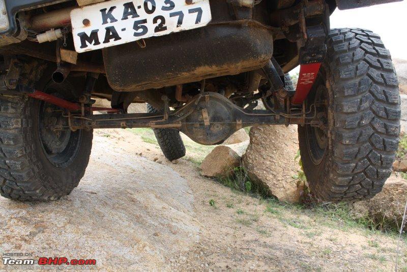

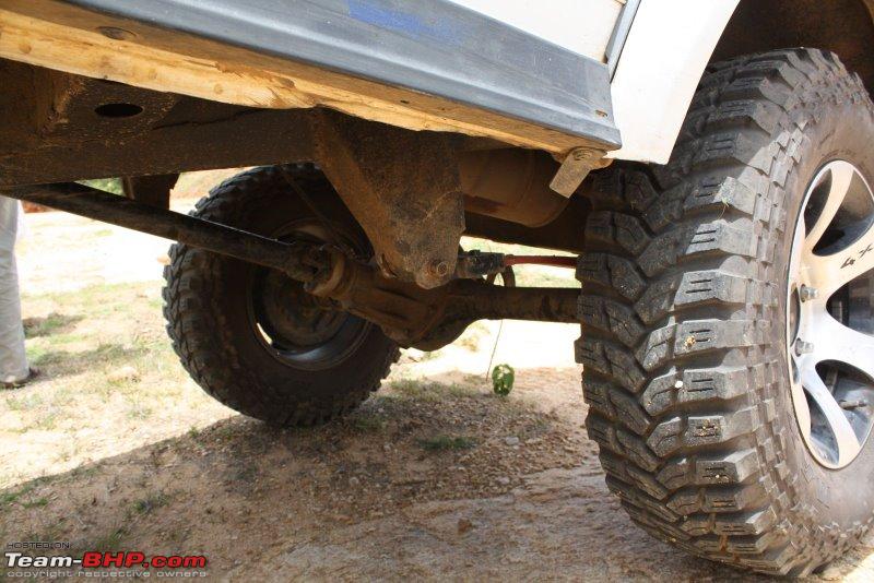

Here are some pictures that show how the composite leaf springs flex during articulation. Must say that they performed nicely. (picture Courtesy: Rajesh/Shakir)

Actually, the flex is limited by my shocks. they bottom out quite soon and don't have much travel. Need to plan for longer shocks

Just look at how the front metal leafs of the driver side is nearly bent the other way...

From what I hear is that they have composite leafs for the front also now. They have done enough testing and are now confident of the performance in the front also. They are more stiffer than those at the back.

Nicely is a gross understatement!!!!
from the looks of it they preformed great!!! I mean look at it!!!
