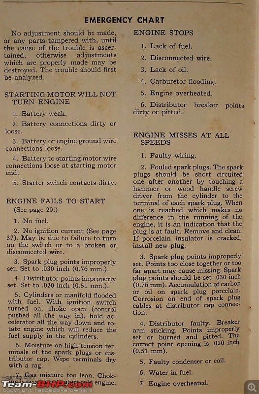

Dear Friends,
This 3B manual is an ocean of info.
For a start I am uploading pics. of, wiring diagram (LHD), Fuel economy tips and trouble shooting chart( 2 pages).
Any particular queries, feel free to PM me and I will put it up on the forum for all to benefit.

hi fazal,
these pages are a treasure mine, specially the wiring diagram i had never seen , post up other pages , perhaps 2 every week and over the week we could elaborate on the pages posted. we could start with the interpretation for the wiring diag in complete detail , as i could not make sense of it in very a very comprehensive way .
sharat

Hi Sharat,
What about the diagram was not clear, please elaborate for me to get it right.
If there are members who would save pages if sequentially posted here it is worth, or else anyone with specific queries an PM me.
