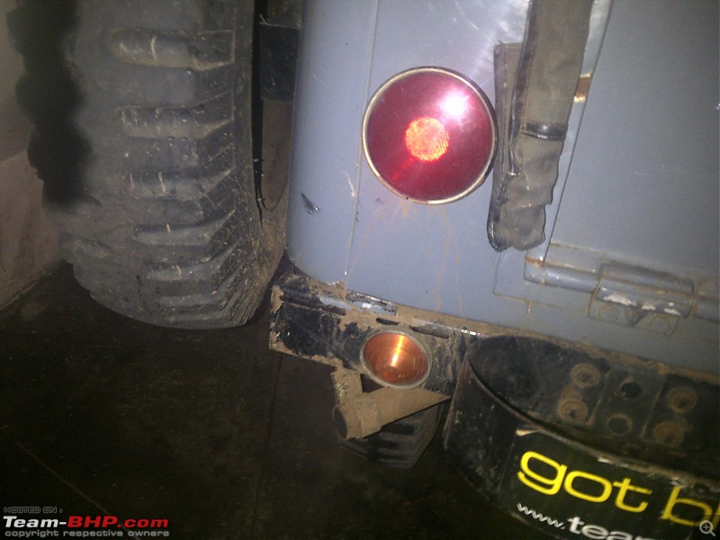

Broke my tail lights due to some over enthusiastic end of monsoon escapades
The usual store in Mumbai is down to it last mismatched set.
Need help in procuring a set or two of the large round and the smaller conical ones.
Dont want expensive imported ones since the jeep is used regularly for OTRs.
Any pointers from other cities appreciated :)
