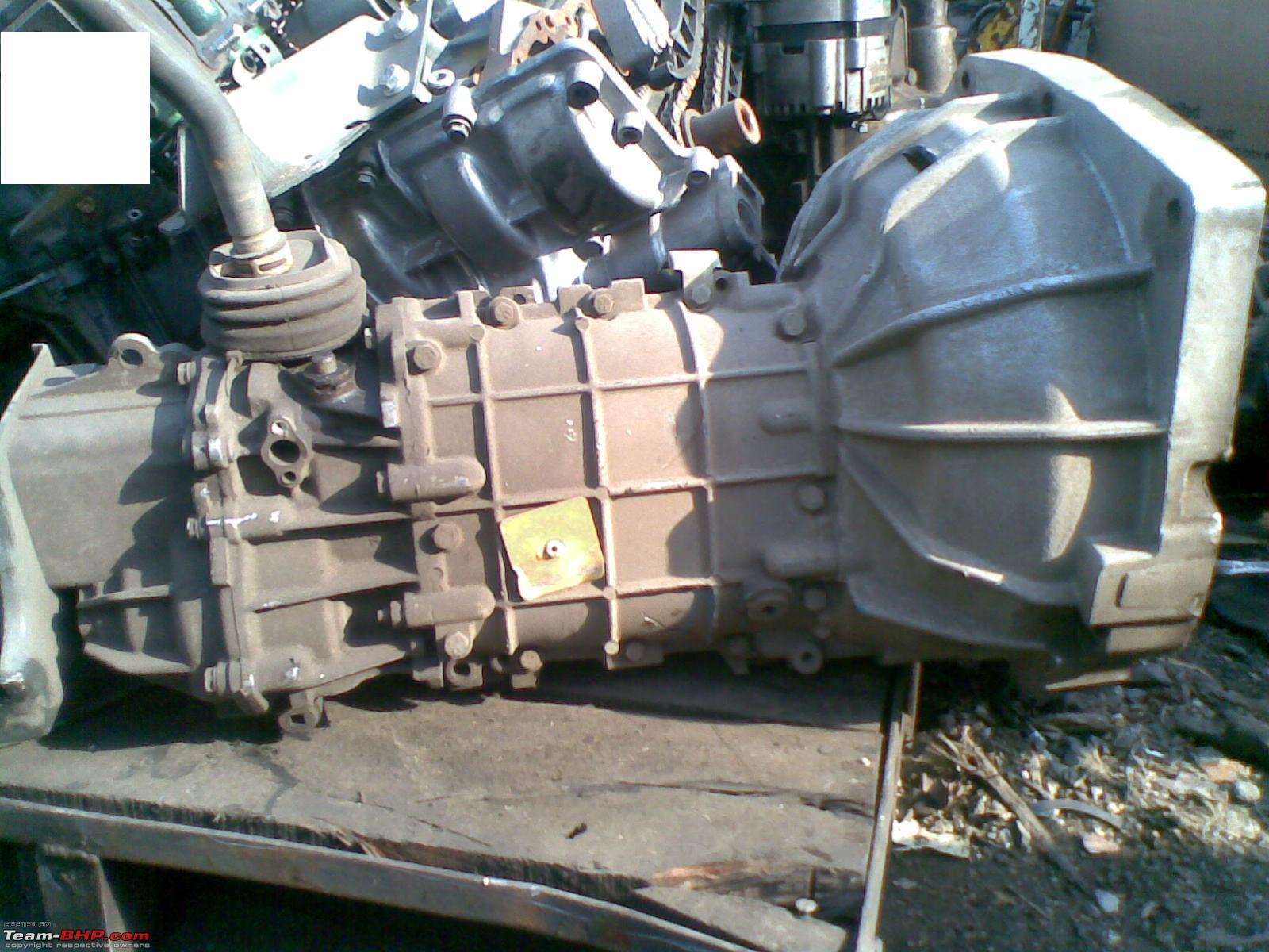

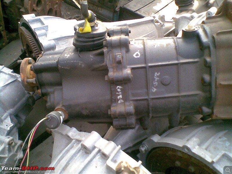

PS- I just realized today the pain and frustration you guys must be going through sourcing parts, when I saw these barely used Transmissions kept for scrap! Alas..
520 :- M&M Engine and Gearbox combos for JEEPs-ngt520.jpg
530 :- M&M Engine and Gearbox combos for JEEPs-ngt530.jpg

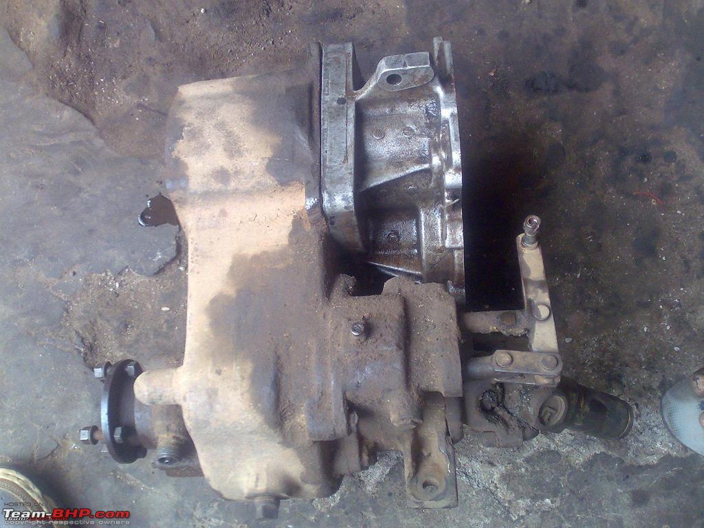

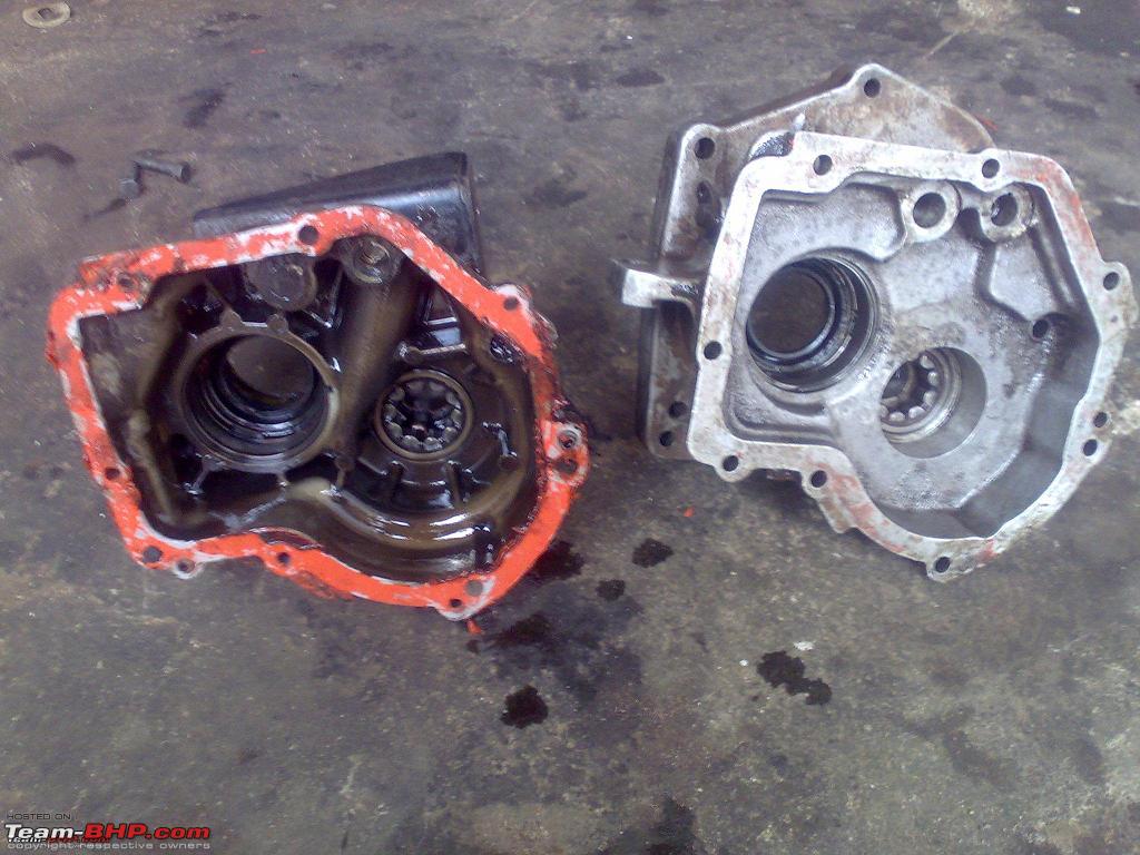

Mr Spike! Please give credit to original photographer!!
http://www.team-bhp.com/forum/attach...arbox-side.jpg
http://www.team-bhp.com/forum/attach...er-housing.jpg

^^ Jyobeb, all credits to you! I have no idea from where I got these pics. Thanks again for clarification.

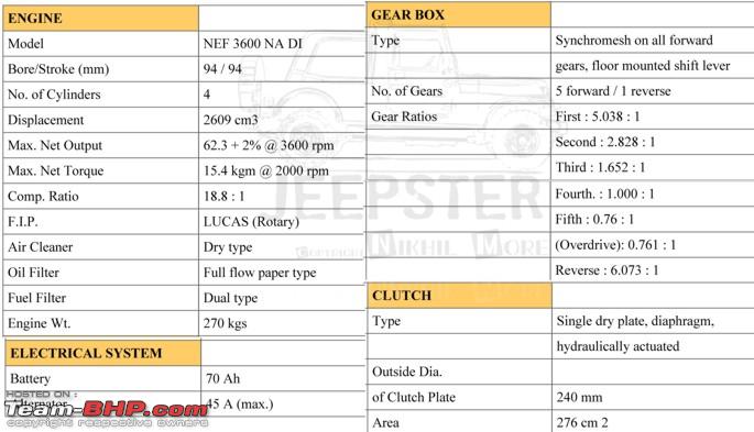

whats the opinion of jeep gurus on the NEF 3600 NA DI engine with factory fitted 5 speed GB?
will it be possible to add T18 or BW 1350 with some Jugaad?
I personally don't see a point to this transplant. Doesn't achieve much in terms of power or torque. What engine is this? Which vehicle uses it? Going by the specs, even the D2 engine in the Xylo is a good choice but as its been launched recently finding one will be tough.
this is from a MM CABKING TRUCK so i am confused about its type.
the cabking came with following three engines.
NEF 3600 NA DI
2609 cc
62 bhp
150 nm
lucas rotary FIP
EUV 3600 NA DI
2609 cc
62 bhp
150 nm
lucas rotary FIP
MDI 3200 B
2523 cc
53 bhp
162 nm
mico FIP
XD3P(72 BHP,155Nm of torque) not available in my locality.
XDP 4.90 (62 BHP,112Nm) want to replace.
MDI3200(Direct Injection,63BHP, 180Nm, which is an upgraded version of MDI3000/2350) priced at around 70 to 80 K in second hand market & not available.
the D2 engine is CRDE version & very expensive & not available.
PS: i am getting the Engine with starter, alternator (vaccum pump type) & GB at 37.5K

This engine is very similar to the Scorpio 2.6, except that it is normally aspirated. Its very large and heavy with the same dimensions as the Scorpio 2.6l. Not a good idea.
520 :- Attachment 499074
530 :- Attachment 499076
Why are they kept for scrap? What is the scrap price expected ?
Also, any pointers on a slicker GB than the NGT 530 for these engines?
Has anyone opened the GB to work on the leverages to make it better?
Inputs appreciated.
Some of these are removed from test vehicles, some are removed from new vehicles so that a prototype can be substituted. Some are never used at all. As inventory builds up they are sold.
Can range from a few hundreds to a few thousands, depends on the seller. But one thing is sure, these guys get stuff for a pittance (sometimes things are sold in terms of their weight)
You will see that soon
Yes, not just the GB (Synchros mainly) but the actuation mechanisms have also been worked around.
Spike
