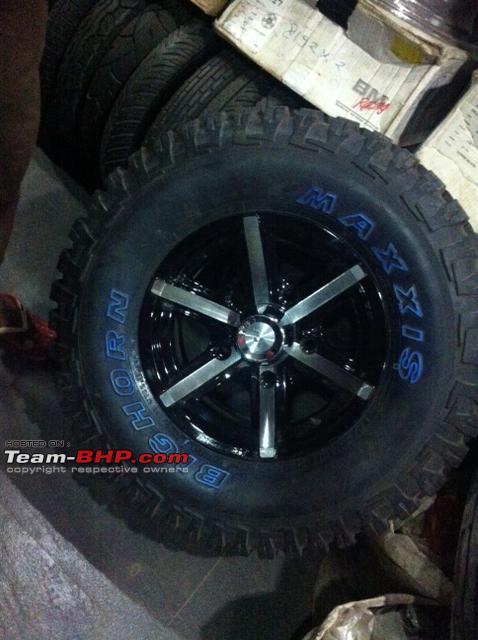

I've just paid for some 31x10.5x15 Maxxis Boghorn MTs!!! Been waiting a long time to some solid MTs on my truck and that day will finally come! Was aiming to get some 32x11.5s but that's just not available in India right now and by the looks of it (after talking to several dealers) they will not be available for a long while either. Just need to go out there and buy myself some new 15" wheels now with some nice negative offset. Thinking of getting something like -10 offset as stock is +10 offset. I want the tyres pushing out of the fenders a bit for that aggressive look. Will post pics once I have them on. Going to ask Swastik Viji to make some -10mm offset BLACK steel wheels for that awesome all black aggressive look.
Heres a picture of them at Pavan Anand's shop in Bombay. They are fitted with some nice alloys there but I want to get something less flashy.

Wow - Vish Congrats on the new shoes, Hope they give you the grip to go where you want!

Now that is one meaty looking shoes!! If you already replaced the old ones, would you be kind enough to serve those hots pics as the next sizzler?

Havent received the tyres yet. Will be getting them only in 4 to 5 days. Also, here are the rims im thinking of putting on. Only small problem is that they are -23mm offset which I think might be a bit much. Stock offset is +10. Still getting opinions from an Australian forum about this matter. Here are the rims: 15x8j BLACK STEELIES
Any of you have advice regarding the negative offset? I understand it will put a strain on joints and stuff. What joints will I need to replace and how often if I do put these on? Thanks
