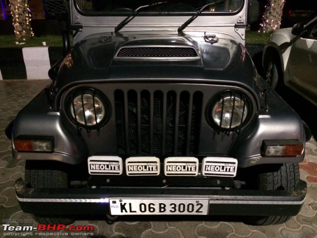

Neo lights replaced with Hella - JCB work lamps thru relay. Completed all electrical works.
Updated head lamps thru relay and 130/100, Dual horns,All light connection with soldering and push sockets,Changed combination switch,roof lights,puddle lamps.
Music system installed with sony xplod series/speakers.More pics to come..

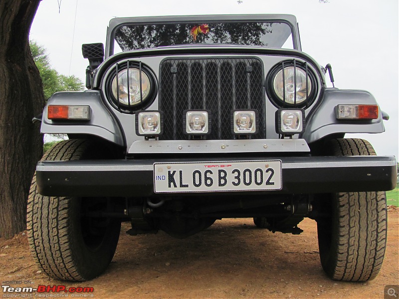

With Grill Mesh inserted

What is it you have on your Thar ? Have you installed a diesel enginer intercooler ? Is it still a Mahindra CRDe engine in there ? And the dashboar of a Thar DI ?
Oh I read the whoe thread - Monk is not a Thar.
Why would an off roader install a Thars side boards ? Its not required use some kind of tubular side steps often called rock sliders in India.
Its a 2002 -MM540 with 2013 NGCS chassis-Loaded with Isuzu trooper 4jg2T Engine and its own 4wd-5spd Gbox running on Bolero 4wd wider tracks axles in the front and rear.
Dash board is from its own -MM540s.
Rock sliders will be installed shortly.
