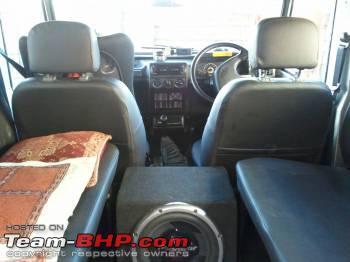

5)ICE with Pioneer DVC sub & sound stream 4ch Sub.
