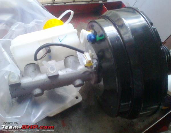

Dear Rajith - simple. The LSPV spring locating bracket mounted on the axle has a long vertical slot. Please give the dimension of the height of the center of the spring mounting pivot from the bottom of the bracket, as you have changed this location. Dealers can then make and end gage and use for other customers' vehicles. Clean air hose is rubbing the master cylinder / reservoir. Need to add an absorber material in between to prevent NVH (noise vibration harshness) path. Alternatively, you can move the air cleaner 25mm in front by using distance spacers in X axis, but do this only as a last resort. Use hose separators to keep NVH path out of this area.
Best regards,
Behram Dhabhar
Would Especially like to thank Sir. Dhabhar Behram, Sir. Ranjith, Sir. Manveet for their guidance for getting the brake upgraded.
"IT ROCKS"
Got the brake booster changed to TANDEM BSTR (8+9) 26.99. Followed exact procedure as mentioned, the result MARVELOUS
Tandem BSTR - Rs.7,908
Brake Oil DOT4 - 450ml - Rs. 323
Removal & Fitting - Rs. 1,000
Mr. Atish Kumar and Mr. Anil Sharma at Koncept Okhla was gracious enough go get the work done under their supervision. It took them 3 hours to surprise me with the new brakes, wow i am amazed by the modification. Brakes feel Confident.
Still wondering why M&M didn't thing of this in the new variant they launched.
Happy Thar'ing

SHARING THE FEEDBACK
Hi Team,
Another delightful moment that I would love to share it with M&M.
Ever since I entered in the Mahindra Family I have been treated with amore, certainty and care by a team of highly dedicated and knowledgeable team, be it in Sales or Service.
To begin with, I would again like to mention the Gala experience I had with Mr. Kunal Sharma (GM Sales) at Bhasin Motors as he took extra care towards delivering the Black Mahindra THAR registration “DL 13 CC 7770” on September 2011.
The stock Thar has a major braking issue and past months I was on a look out for a definite solution. Searched online, talked to people who owned the Thar.
Finally the inventor Mr. Dhabhar Behram guided me very precisely as to what had to be done to get the beast a set of good brakes.
Braking a integral part, so I wanted a professional to get the job done. Friends who got the brake upgraded referred me to Mr. Atish Kumar and Mr. Anil Sharma at Koncept Okhla. I was told that Mr. Anil Sharma was the right man for the job and had upgraded the brakes in over 20 Thar’s.
10th March 2013 I visited Koncept Mahindra Okhla workshop for a Brake Booster Upgrade for my Thar. I was welcomed by Mr. Pradeep (Service Advisor);
shortly Mr. Atish Kumar joined in and introduced me to the detailed upgrade procedure. Mr. Anil Sharma elaborated the upgrade and assured me of great aftermath.
In no time Mr. Pradeep got the job card expanded and detailed it to me –
Job Work – Brake Less Effective (Booster Upgrade to TANDEM Crde) + Brake Oil.
Total Estimate – Rs.10,500/-
Promised Delivery Time – Within - 4Hrs.
Contented as genuine M&M spares were opened in front of me by Mr. Anil and the entire upgrade carried right in front of me. Everything settled into place and nothing had to be pulled apart or drilled into. I was also advised on other problems that Thar owners face, like door rattling, clutch serviceability and diesel fumes polluting the cabin, which I agreed to. Mr. Anil Sharma zealous efforts and brainwave which I must applaud rectified the diesel fume issue in a jiffy.
Finally, I test drove the new brakes.
J WOW J
I was amazed at the result and now the Thar felt Confident.
I would like to thank the entire team of Koncept Okhla for delivering genuine services at reasonable rates.
Even yesterday I experienced “A Job Well Done”

Sir,
I didn't have to move anything, the Air filter is in the same place; as i had a aftermarket fitment for the aircon; didn't have to be moved either.
1. The new MC had a rubber bush which was removed and directly placed instead of the old one.
2. U bracket from the old MC was fitted to the new MC.
3. Brake oil sensor wire was replaced with old one as the connection socket was different and i didn't want to cut the wire.

Pictures Updated for Better Clarity - Might Help Some One

Originally Posted by davidashish View Post
Sir,
Also,
Kindly advise, i've done 44,000Kms and my clutch has gone hard and im facing problem with the 1st and reverse gear. I consulted the koncept guy, he says the clutch of the Thar lasts only 40,000Kms. Is that so?
Replace clutch fluids,Do bleeding at slave cylinder, adjust the play near the pedal in U bolt by removing the quarter pin. Check whether you have used synchro oil in the gear box.Drive for a week. Still problem exist, remove the clutch assy.
Well, all is well that ends well. So Bhasin Mahindra sold you the vehicle and Koncept Mahindra solved your problem .. what did Bhasin Motors have to say about this job - or did you not go to them at all.
Personally, I have had poor sales experience from the Bhasin motors guys so eventually did not buy the Thar from them. Koncept Motors has been satisfactory till date but my first service is still due. Lets see how that goes.
Anyhow, those interested in getting this under warranty may refer this link for more info. Just cross-posting here so that all can get the benefit, since subject is the same.
http://www.team-bhp.com/forum/4x4-ve...ml#post3067799
Hi David
I went through the brake booster installation pictures which you had posted. Do you mean to say that you have removed the felt material that was present behind the brake booster? If yes, then it is a serious issue and has to be put back immediately. It is provided there for a purpose, that is to take up all the undulations in the fire wall while tightening the booster mounting bolts. Eliminating this, will result in serious brake drag issue.
W_C
