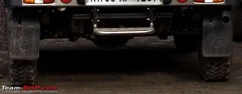

Does any one think the dismal performance of the Gurkha in OTR is becoz of the below marked(in RED) indication the reason for it? In other words the Gurkhas tires seem to be quite thin compared to the jeeps in the picture, i suppose the kerb weight is also more for the gurkha, which adds to the ground pressure.
Does anyone think changing the tyres and going in for the thicker tyres with 15inch rim would help in improving performance?
I am not sure whose Gurkha this is, but Samurai's cousin's Gurkha has highway tires and not off-road tiers. Oldmodel's Gurkha came with the JK LT2000 off-road tires. Not sure which tires you have, but the tread pattern is more important than the width. If you want to downgrade from your 16 inch rims to 15 inch rims, go for the 31x10.5 tires which match very close in overall diameter to the stock 700x16 tires that come on the Gurkha but it is much wider. Since the overall diameter is close to the OEM tires, it will affect your top speed or milage only marginally. Wider tires that most closely match the diameter is 235/85/16. These the OEM tires that come on the Landrover defender and the landcruiser 70 series. Unfortunately this size is not sold in India so would have to be imported. I contacted the Yokohama distributor for South India and he said he could get it for me when the next container was imported. But since Oldmodel took the Gurkha, I didn't follow up with him after that.
This Gurkha belongs to a Bangalore guy called Srinath. It did have off-road tyres.
A close look of the tyres.

I have seen the same tyres on the Land Rover which some what look the same as this one.. even the Army version of the G-Wagen have the same tyres on them! but does haveing similar tread alone enough? considering the Rover and G-wagen have Bridgestone tyres and Gurkha has a J.K tyre which is a copy of it.. Why the dismal performance still?

If Gurkha has everything including the tyres, diff locks and front independent suspions then what still makes it a bad off roader?
The driver is a huge variable.
For eg:
An 300bhp EVO is no way a bad car. But, the difference between a regular driver vs an enthusiast vs Tommi Makkinen is like day and night in all.
It is going to take years of experience to understand and read dirt and terrain ,plus master techniques and seeing the correct lines in off-road.
