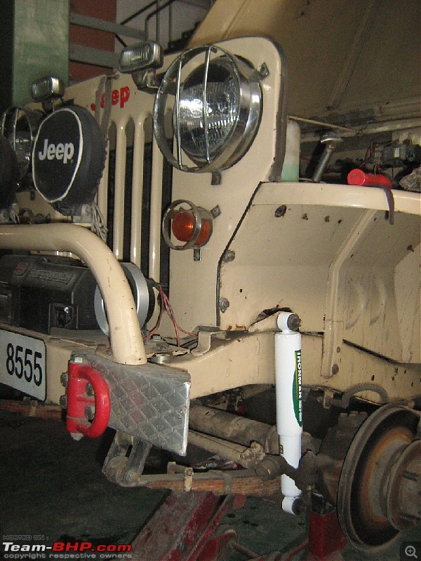

Congratulations on the jeep,since there was a small discussion on the shocks well i am using ironman shocks on my 3b for quite sometime and i must say,there is a difference in the ride and comfort as compared with the stock ride,the jeep is running stock leaf spring setup .Attaching a click.I personally like the ride now,specially the pot holes are creased out,offroad the jeep behaves better.
regards
renegade
