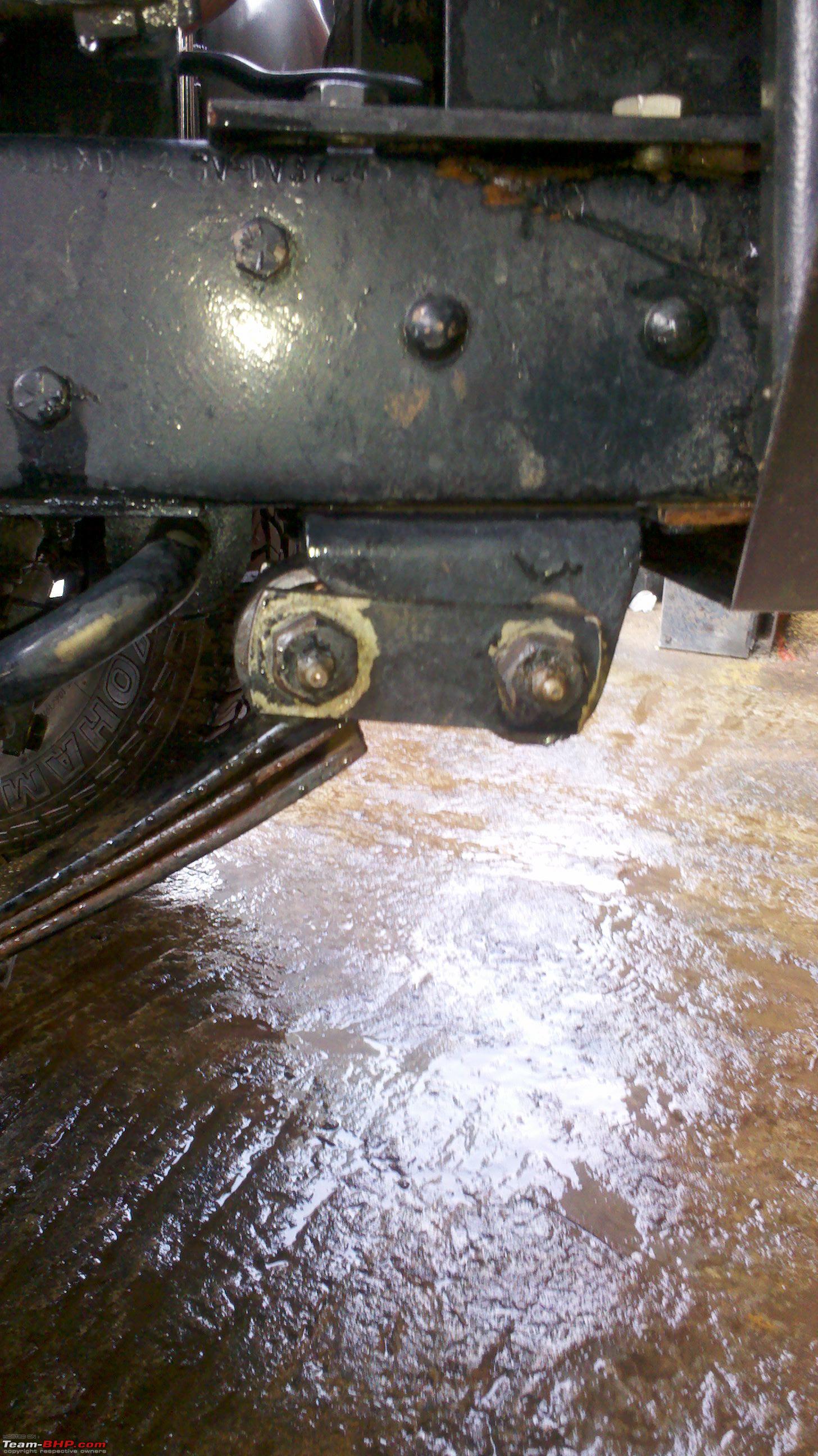

After parking the Jeep on Saturday, I never got the time to get back to it until today morning. I wanted to get the water service done.
When I moved the Jeep out of the basement to remove all the stuff from the back, I noticed that the Jeep was listing like a leaky boat.
Hardtop MM550 : A family friendly offroader joins Team-BHP-img_20130129_103557.jpg
The rear right tyre was fully flat, but that didn't explain this tilt. So I went around inspecting the suspension and found this.
The front right leaf spring.

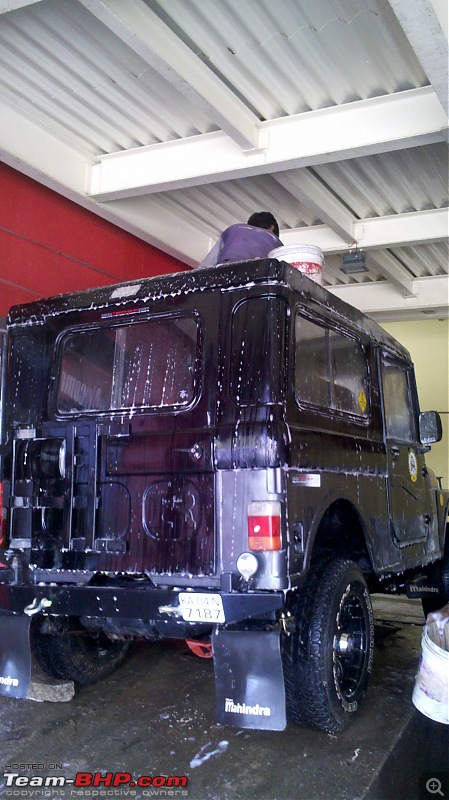

It finally got a 500 rupee bath, the cleaner even got on top of the hard top to do a thorough job.
Hardtop MM550 : A family friendly offroader joins Team-BHP-img_20130129_111146.jpg

That shackle reversal should have given you a Nasty feedback in your steering/ride, surprised you caught it (so far) after returning home. It would have happened only in a trail (extreme arti) and no where on the roads.

3) The front right leaf is damaged.
Sharath, please beware about this. Its not so simple as it looks. It is not shackle reversal, but the reason for this damage is that the shackle/tyre has hit somewhere so hard that the entire set up is pushed backwards. This is why the leaf spring bent.
The main issue about this damage is that, the entire drivetrain is pushed backwards, and the only area that prevents the movement is the transfer case mounting on the long member.
Please remove and check for cracks and if possible re-inforce, or else, I'm sure it will give up someday. Mine had.. :(
