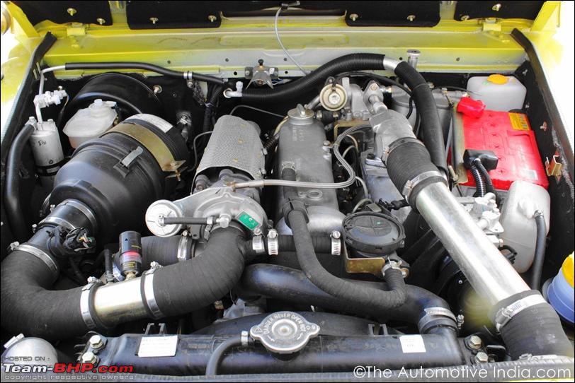

Does the Gurkha have electronic engine control or is it an old-school engine devoid of electronics? I was of the belief that Gurkha engine was old-school turbodiesel until i saw the picture below. There is a sensor that looks like a MAF just in front of the air filter housing. Whats the story?!
Review: The Force Gurkha 4x4-forcegurkhaengine.jpg
Attachment 1346110
Src: TheautomotiveIndia
The old Gurkha was an old school Turbo-diesel.
The new Gurkha is an old school turbodiesel with a pacemaker
Well I hoped for a more technical answer. What does the MAF sensor do in the Gurkha? Is the fueling electronically controlled?
Attachment 1346110
It is an ECU controlled engine, mainly to meet emissions requirement. But the next question will be, and the answer will probably be yes, can the engine be made to run as a simple DI, without the ECU/Electronic interferences.
I hope other members will not get infracted for posting one-liners that doesn't add any value to the discussion
I am considering a hardtop diesel 4WD under 12L and have only two vehicles i like fit in my budget; one is the Gurkha and the other a Scorpio S4 4WD. I just finished reading the review here by 4x4addict and samurai and on automotiveindia and have come to the conclusion that the Scorp offers more for my money. So while reading the reviews when i came across the MAF sensor i thought i would ask about it here because its presence was interesting and unexpected.
Anyway i think i found the answer to my question.
All modern vehicles require ECU + electronics to meet emission norms. So you won't find anything new in the market with just an old school electronic free turbo diesel.
Electronics free was one attraction i had towards Gurkha. Maybe i missed this in the test drive reports earlier. By the time i finished reading this report i came to the conclusion that it wouldn't work out so well as a family vehicle for me.
Now i understand the joke
Electronics are purely for emission control.
Stay away from this bro, if you don't believe me, take your family along and do a test drive. S4+ 4WD is much better choice...
